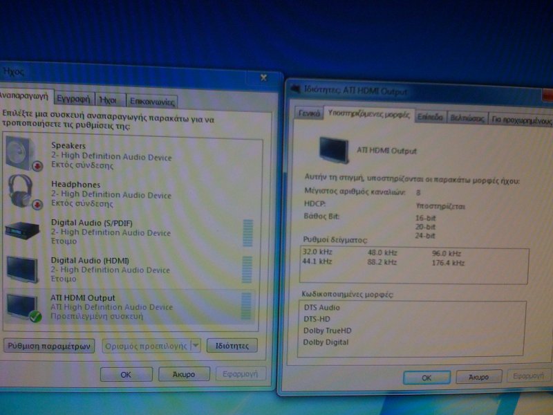

Πως μπορείς να κρίνεις ότι ο <ΑΤΙ hdmi audio driver ειναι μαπα> η δικιά μου εγκατάσταση είναι η ακόλουθη:
[ATTACH]39953[/ATTACH] [ATTACH]39954[/ATTACH]
Τον ΑΤΙ εχεις, αλλιως στη δευτερη εικονα θα ελεγε "Realtek HDMI output"

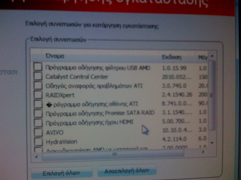

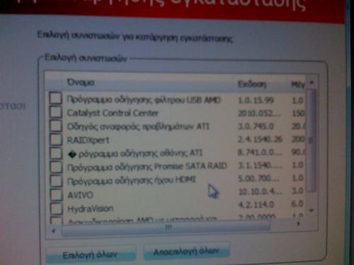

Προφανως βγαζετε τον ΑΤΙ και μετα βαζετε τον realtek....αν και οποτε το εχω κανει, το ειχα δει σαν ευκαιρια να ανανεωσω και τους drivers οποτε εγκατεστησα τους τελευταιους ξε-τσεκαροντας το "ati hdmi/dp audio driver" κατα την εγκατασταση και μετα απλα εβαλα τον realtek...

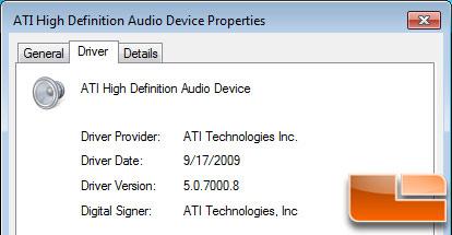

As we mentioned earlier the ATI Radeon HD 5850/5870 graphics cards support bitstreaming Dolby TrueHD / DTS-HD Master Audio with Blu-Ray DRM support via the card's HDMI connector. ATI has been working closely with Cyberlink and their latest version of PowerDVD 9 actually supports these new audio features! Cyberlink was kind enough to let Legit Reviews take a very early version of their v9.0.2010.0 software for a test drive to take a peek at bitstreaming audio. Since this version of PowerDVD is beta, they asked us not to review/evaluate the PowerDVD player, but rather just try out the audio streaming that we wanted to look into.
ATI Radeon HD 5870 Bitstream Audio Driver
Late last week ATI released driver version 5.0.7000.8, which is the driver that we used for our audio testing on the Radeon HD 5870 graphics card. Just to give you a little background here in case you need it, DVDs use either Dolby Digital or DTS encoding for their audio tracks. Blu-Ray supports Dolby Digital, DTS, Dolby Digital TrueHD, DTS-HD Master Audio and uncompressed LPCM. Both Dolby Digital TrueHD and DTS-HD Master Audio are known to be great as they are touted as being lossless when decoded properly as it is possible to get a bit for bit identical copy of the audio the studio originally mastered for the movie. Since the ATI Radeon HD 5850/5870 graphics cards support bitstreaming Dolby TrueHD / DTS-HD Master Audio with Blu-Ray DRM support via the card's HDMI connector it means that the audio quality when it comes to Blu-Rays should be better than nearly anything else on the market today.
πηγη :http://www.legitreviews.com/article/1080/16/
5.0.7000.8 :http://support.amd.com/us/kbarticles/Pages/ATIRadeonHD5800seriesrecommendedgraphicsdriver.aspx
Θα εγκαταστήσεις μεμονωμένα τον οδηγό HDMI
