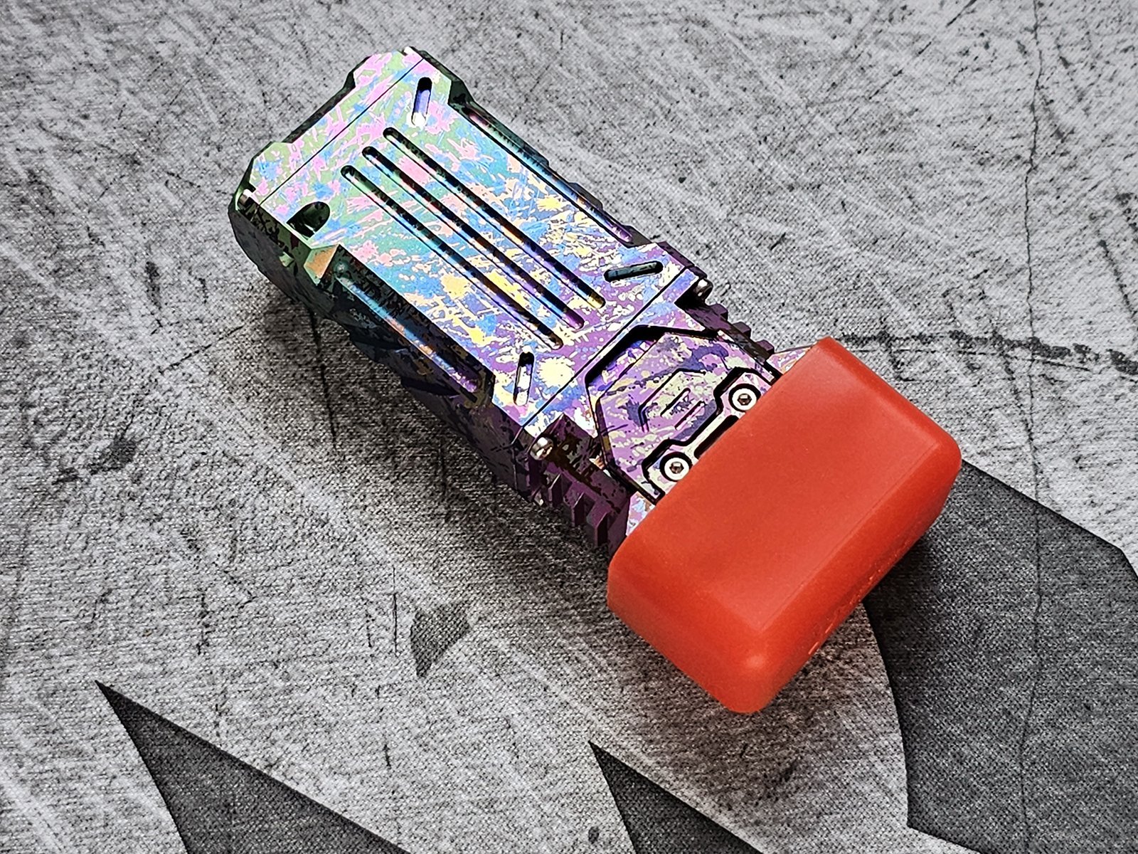

The Wuben X2 Titanium Ink Splash is definitely unconventional and unique. Its rectangular shape maximizes pocket comfort and will not roll off the table. It is also nice to hold in the hand as all corners are chamfered and perfectly finished, with no sharp edges.
The Ink Splash colour scheme is definitely a riot and will get noticed!

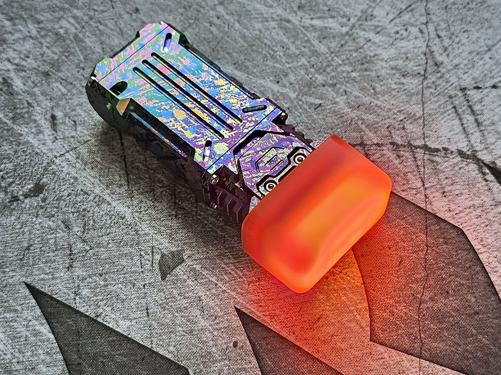

The silicon diffuser can be placed over the lens to provide a diffused red light.

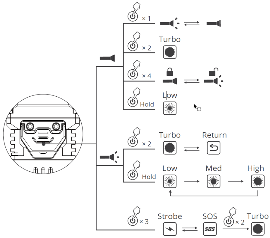

The user interface of the Wuben X2 Titanium Ink Splash, as shown in the user manual, can be seen in the diagram below:
From Off:
- Click to turn on.
- Hold to turn on directly to low mode, regardless of the previous mode used.
- Double click to turn on directly to Turbo, regardless of the previous mode used.
- Triple click to turn on directly to strobe. Triple click again for SOS and triple click again to go back to strobe etc. Double click to go to Turbo.
- Quad click to lock the torch. The torch flashes 3 times to indicate it has been locked.
From On:
- Click to turn off.
- Hold to cycle through the main modes low, medium and high.
- Click and hold to programme current main mode (explained in Modes and Programming section).
- Double click to go to Turbo.
- Triple click to go to strobe. Triple click again for SOS, triple click again to go back to strobe etc. From there click to go to the previously used main mode (low, medium or high) or double click to go to Turbo.
From Locked:
- Quad click to unlock and turn on in low mode.
- Click, wait 0.5 sec, double click, wait 0.5sec, triple click to reset torch to factory default. The torch unlocks and turns on in low mode to indicate a successful factory reset.

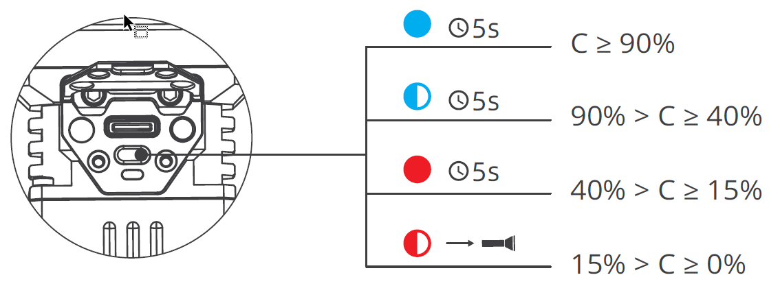

It also features an indicator LED near the bottom of the button. The LED lights as follows to indicate the battery level.

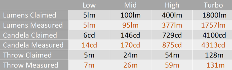

The output levels of the Wuben X2 Titanium Ink Splash can be seen in the following table. The numbers provided by Wuben are in black and my measurements are in orange.
I do not own a multi thousand dollar worth integrating sphere, just a logging Lumen meter and a home made integrating tube. The array is calibrated with 3 separate, professionally measured lights and gives me consistent results, but there is definitely room for error and deviations are to be expected.
My Lumen measurements show that Wuben is quite honest in their specifications for the Wuben X2 Titanium Ink Splash as my measured values are well within the margin of error from the provided values.
The Candela and Throw I measured indicate the same, as I actually measured them to be slightly higher than indicated in the specifications.

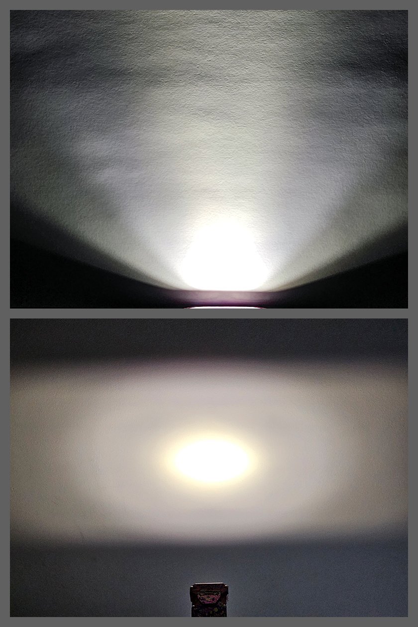

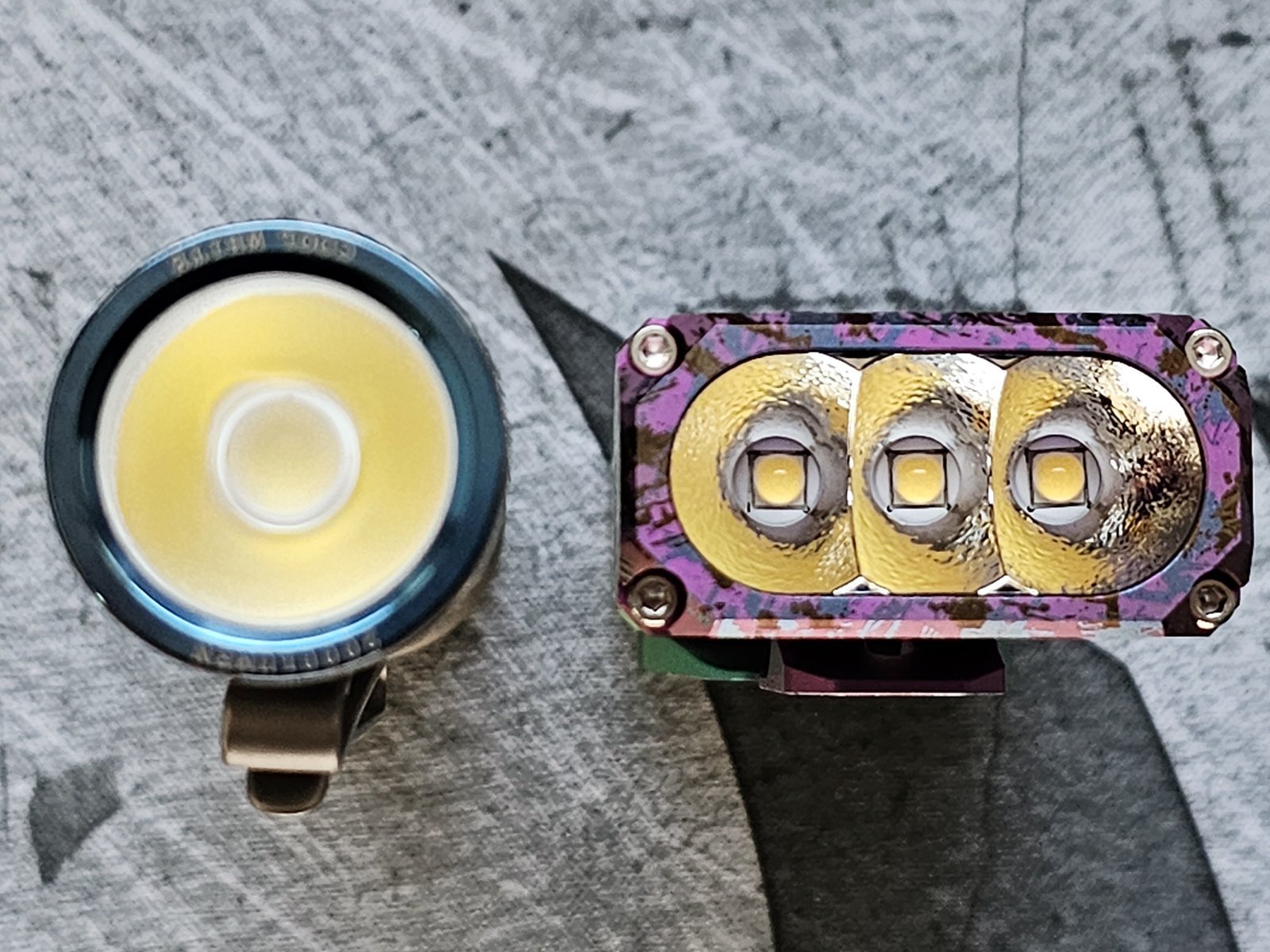

In any case, here is a comparison photo of the Wuben X2 Titanium Ink Splash on the right and the Olight Baton Pro on the left. The white balance was locked at 5500K. It is obvious that the tint of the Wuben X2 Titanium Ink Splash is warmer and significantly more neutral than that of the Olight Baton Pro.
Beam Profile
The beam pattern of Wuben X2 Titanium Ink Splash is very floody and, similarly to the torch front, rectangular. Even though I found that strange to begin with, it is actually quite usable as the light is directed where you need it and not at the sky.

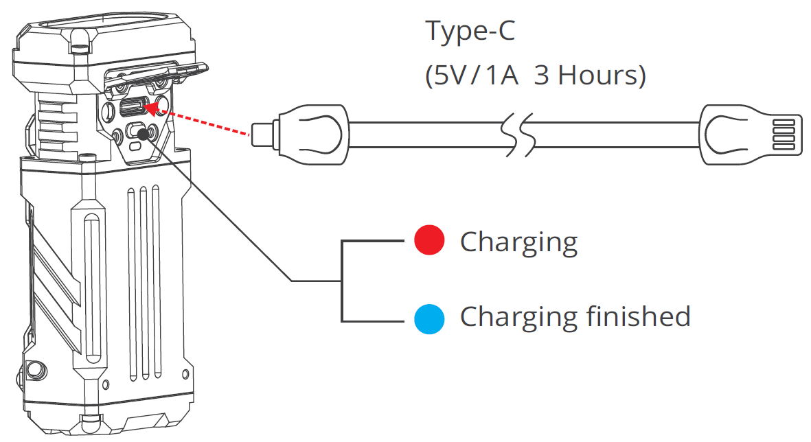

The Wuben X2 Titanium Ink Splash utilizes a proprietary, non removable (officially) battery pack, which incorporates 2 14500 Li-Ion batteries with a total capacity of 2000mAh.
The included lanyard doubles as a charging cable!
The USB C plug on one end of the lanyard plugs into the USB C charging port under the button of the Wuben X2 Titanium Ink Splash.
The indicator LED lights up red while charging and blue to indicate that the charging has been completed.
The Wuben X2 Titanium Ink Splash can also be charged with any other USB A to USB C or USB C to USB C charging cable and any 5V charger, including Power Delivery enabled chargers.
The following chart shows the charging of the Wuben X2 Titanium Ink Splash, after it had been depleted completely to the point where the torch turned itself off due to low voltage protection. The charging lasted less than the 3 hours declared in the specifications and was completed in 2 hours, 37 minutes and 31 seconds. It required 11.1245Wh of energy.
As the current draw never exceeded 1A, any 5V 1A charger can be used to charge the Wuben X2 Titanium Ink Splash at full speed.
