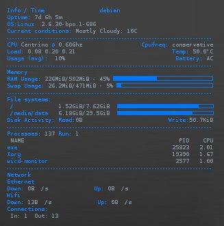

Θα βάλω κι εγώ το screenshot και το conf αρχείο μου.
Το αρχείο conf είναι το εξής:

# min_port_monitors 8
# Allow each port monitor to track at least this many connections (if 0 or not set, default is 256)
# min_port_monitor_connections 64
# none, xmms, bmp, audacious, infopipe (default is none)
# xmms_player audacious
# With explanation
# ${color #0077ff}File systems: free/total % used
TEXT
${color #0077ff}Info / Time ${alignc}${color #0077ff}$nodename
${color #0077ff}Uptime:$color $uptime
${color #0077ff}OS:$sysname $color $kernel
${color #0077ff}Current conditions:$color ${execi 300 ~/scripts/weather.sh "EUR|GR|GR007|ATHENS"}
${color #0077ff}${stippled_hr 2 1}
${color #0077ff}CPU$color Centrino ${color #0077ff}@ $color${freq_g}Ghz ${alignr}${color #0077ff}Cpufreq:$color ${execi 20 cat /sys/devices/system/cpu/cpu0/cpufreq/scaling_governor}
${color #0077ff}Load:$color $loadavg ${alignr}${color 0077ff}Temp: $color${execi 20 sensors | grep "temp1" | cut -c15-21}
${color #0077ff}Usage (avg): $color ${cpu cpu}% ${alignr}${color 0077ff}Battery:$color $battery
${color #0077ff}Memory
${color #0077ff}RAM Usage:$color $mem/$memmax - $memperc% ${color #0077ff}$membar
${color #0077ff}Swap Usage:$color $swap/$swapmax - $swapperc% ${color #0077ff}${swapbar}
${color #0077ff}/ $color${fs_free /}/${fs_size /} ${alignr}${color #0077ff}${fs_bar 5,140 /}
${if_mounted /media/data} ${color #0077ff}/media/data $color${fs_free /media/data}/${fs_size /media/data} ${alignr}${color #0077ff}${fs_bar 5,140 /media/data} $endif
${color #0077ff}Disk Activity: Read:${color}${diskio_read} ${alignr}${color #0077ff}Write:${color}${diskio_write}
${color #0077ff}Processes:$color $processes ${color #0077ff}Run:$color $running_processes
$color NAME $alignr PID CPU
${color #0077ff}${top name 1} $color$alignr ${top pid 1} ${top cpu 1}
${color #0077ff}${top name 2} $color$alignr ${top pid 2} ${top cpu 2}
${color #0077ff}${top name 3} $color$alignr ${top pid 3} ${top cpu 3}
$if_mpd_playing$color MPD - $mpd_status
${color #0077ff}$mpd_smart $alignr $mpd_percent %
$endif${color #0077ff}${stippled_hr 2 1}
${color #0077ff}Network
${if_up eth0}${color #0077ff}Ethernet
${color #0077ff}Down:$color ${downspeed eth0}/s${color #0077ff} ${offset 62}Up:$color ${upspeed eth0}/s
$endif${if_up eth1}${color #0077ff}Wifi
${color #0077ff}Down:$color ${downspeed eth1}/s${color #0077ff} ${offset 62}Up:$color ${upspeed eth1}/s $endif
${color #0077ff}Connections:
$color In: ${tcp_portmon 1 32767 count} Out: ${tcp_portmon 32768 61000 count}
Γενικά είναι βασισμένο σε ένα άλλο config αλλά δεν θυμάμαι απο ποιό φόρουμ το είχα βρει, νομίζω του Arch-linux.
Κάτι που πρέπει να σχολιάσω είναι το script για τον καιρό:
#!/bin/sh
#AccuWeather (r) RSS weather tool for conky
#USAGE: weather.sh <locationcode>
#(c) Michael Seiler 2007
METRIC=1 #Should be 0 or 1; 0 for F, 1 for C
if [ -z $1 ]; then
echo
echo "USAGE: weather.sh <locationcode>"
echo
exit 0;
fi
curl -s http://rss.accuweather.com/rss/liveweather_rss.asp\?metric\=${METRIC}\&locCode\=$1 | perl -ne 'if (/Currently/) {chomp;/\<title\>Currently: (.*)?\<\/title\>/; print "$1"; }'
είναι γραμμένο για laptop (γι'αυτο θα παρατηρήσετε και το CPUFREQ) και πρέπει να έχετε εγκατεστημένα τα lm-sensors (για την θερμοκρασία) και PERL για το script του καιρού.

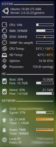

Επειδή ήθελα ένα system monitor και το λαπτοπ δεν είναι και της τελευταίας γενεάς ξαναγύρισα στο conky που το είχα παρατήσει μετά την εγκατάσταση των ubuntu 10.04.
Διαβάζοντας διάφορα forums σχετικά κατέληξα στο
http://ubuntuforums.org/showthread.php?t=281865&page=1310
.conkyrc
# Use Xft?
use_xft yes
xftfont Droid Sans:size=8
xftalpha 0.8
text_buffer_size 2048
# Update interval in seconds
update_interval 2
# This is the number of times Conky will update before quitting.
# Set to zero to run forever.
total_run_times 0
# Create own window instead of using desktop (required in nautilus)
own_window yes
own_window_transparent yes
own_window_type override
#own_window_hints undecorated,below,sticky,skip_taskbar,skip_pager
# Use double buffering (reduces flicker, may not work for everyone)
double_buffer yes
# Minimum size of text area
minimum_size 182 0
maximum_width 182
# Draw shades?
draw_shades no
default_color D6D6D6 #4D4D4D
# Draw outlines?
draw_outline no
# Draw borders around text
draw_borders no
# Stippled borders?
stippled_borders 0
# border margins
border_margin 5
# border width
border_width 1
# Text alignment, other possible values are commented
#alignment top_left
#alignment top_right
#alignment bottom_left
alignment bottom_right
# Gap between borders of screen and text
# same thing as passing -x at command line
gap_x 10
gap_y 30
# -- Lua Load -- #
lua_load ~/.draw_bg.lua
lua_draw_hook_pre draw_bg
TEXT
SYSTEM ${hr 2}
${goto 6}${voffset 6}${font OpenLogos:size=22}u${font}${goto 36}${voffset -18}${pre_exec cat /etc/issue.net} $machine
${goto 36}Kernel: ${kernel}
${hr 2}
${goto 6}${font StyleBats:size=16}A${font}${voffset -4}${goto 32}CPU: ${cpu}% ${alignr}${cpubar cpu0 8,60}
${goto 6}${voffset 4}${font StyleBats:size=16}g${font}${voffset -4}${goto 32}RAM: ${mem} ${alignr}${membar 8,60}
${goto 6}${voffset 4}${font StyleBats:size=16}x${font}${voffset -4}${goto 32}DISK: ${diskio}${alignr}${diskiograph 8,60 F57900 FCAF3E}
${goto 6}${voffset 4}${font StyleBats:size=16}j${font}${voffset -4}${goto 32}SWAP: $swapperc% ${alignr}${swapbar 8,60}
${goto 6}${voffset 4}${font Devil inside:size=16}1${font}${voffset -4}${goto 32}CPU Temp: ${alignr}${execi 1800 sensors | grep 'temp1' | cut -c15-16}°C / ${color #FCAF3E}${exec sensors | grep 'temp1' | cut -c33-35}°C$color
${goto 4.5}${voffset 2}${font Poky:size=15}y${font}${voffset -6}${goto 32}HD Temp:${alignr}${execi 1800 hddtemp /dev/sda -n --unit=C}°C / ${color #FCAF3E}65°C$color
${goto 6}${voffset 4}${font StyleBats:size=16}q${font}${voffset -4}${goto 32}Uptime: ${alignr}${uptime}
${goto 6}${voffset 4}${font StyleBats:size=16}k${font}${voffset -4}${goto 32}Processes: ${alignr}$processes ($running_processes running)
${voffset -1}HD ${hr 2}
${goto 3}${voffset 4}${font Poky:size=16}H${font}${goto 29}${voffset -11} Root: ${fs_used_perc /}%${alignr}${fs_size /}
${goto 29} Free: ${fs_free /}${alignr}${fs_bar 8,60 /}
${goto 3}${voffset 8}${font Poky:size=16}H${font}${goto 29}${voffset -11} Home: ${fs_used_perc /home}%${alignr}${fs_size /home}
${goto 29} Free: ${fs_free /home}${alignr}${fs_bar 8,60 /home}
${voffset -1}NETWORK ${hr 2}
${if_up eth1}
${font Poky:size=14}Y${font}${goto 32}${voffset -8}SSID: ${wireless_essid eth1}
${goto 32}Signal: ${wireless_link_qual eth1}% ${alignr}${wireless_link_bar 8,60 eth1}
${voffset 4}${font VariShapes Solid:size=14}q${font}${goto 32}${voffset -6}Up: ${upspeed eth1}${font} ${alignr}${upspeedgraph eth1 8,60 F57900 FCAF3E}
${goto 32}Total: ${totalup eth1}
${voffset 4}${font VariShapes Solid:size=14}Q${font}${goto 32}${voffset -6}Down: ${downspeed eth1}${font} ${alignr}${downspeedgraph eth1 8,60 F57900 FCAF3E}
${goto 32}Total: ${totaldown eth1}
${voffset 4}${font Poky:size=13}w${font}${goto 32}${voffset -8}Local IP: ${alignr}${addr eth1}
${goto 32}Public IP: ${alignr}${execi 3600 /home/inglor/.wan_ip}
# |--ETH0
${else}${if_up eth0}
${voffset -13}${font VariShapes Solid:size=14}q${font}${goto 32}${voffset -6}Up: ${upspeed eth0}${font} ${alignr}${upspeedgraph eth0 8,60 F57900 FCAF3E}
${goto 32}Total: ${totalup eth0}
${voffset -2}${font VariShapes Solid:size=14}Q${font}${goto 32}${voffset -6}Down: ${downspeed eth0}${font} ${alignr}${downspeedgraph eth0 8,60 F57900 FCAF3E}
${goto 32}Total: ${totaldown eth0}
${voffset -2}${font Poky:size=13}w${font}${goto 32}${voffset -4}Local IP: ${alignr}${addr eth0}
${endif}${else}${voffset 4}${font PizzaDude Bullets:size=12}4${font}${goto 32}Network Unavailable${endif}${endif}
${voffset -1}
