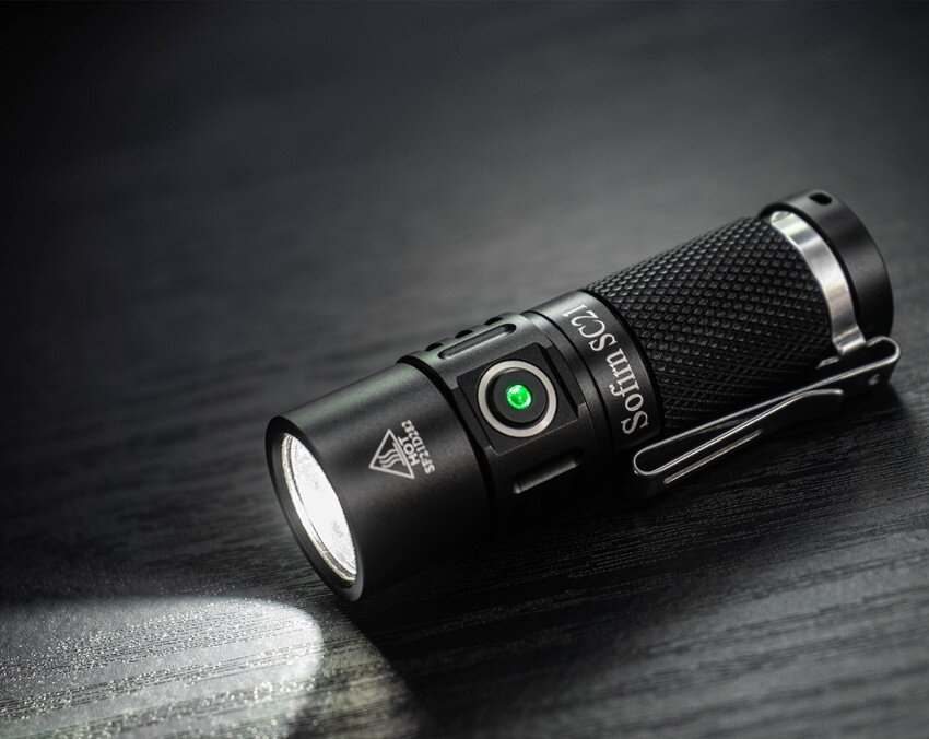

    Today's review is about a light that ticks all those boxes, and then some: The Sofirn SC21.
    The Sofirn SC21 is a small, powerful and budget friendly light that also features a high CRI emitter and onboard charging. Intrigued? Read on to find out more!

    The Sofirn SC21 is made of aluminium and features a side button with an LED charge indicator. On the opposite side of the side button there is a rubber flap with the USB logo engraved on it.
    The flap can be opened to reveal a USB type C charging port.
    The tail is magnetic and the magnet is strong enough to hold the weight of the torch in any orientation. There are also 2 lanyard holes and 2 respective grooves so the lanyard does not compromise the ability of the light to tail stand.
