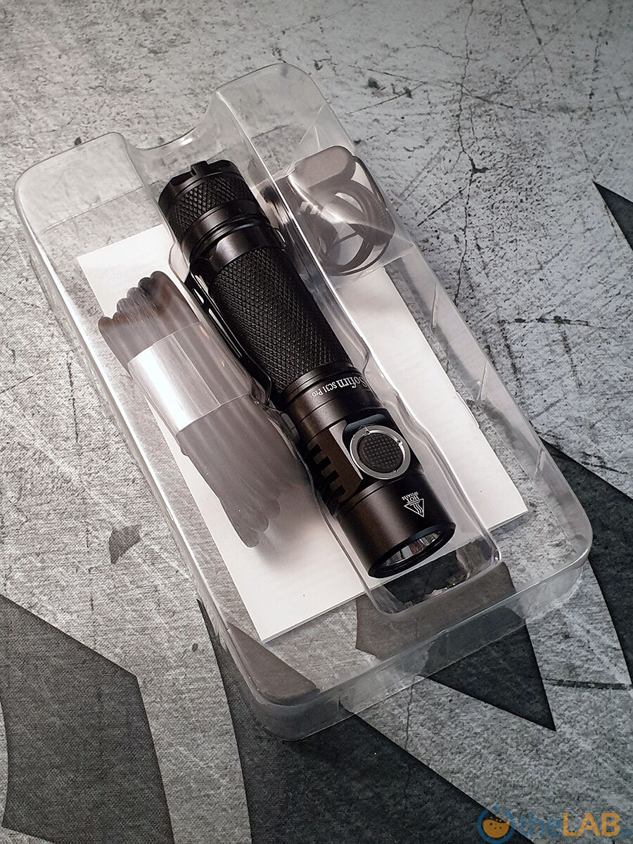

    Inside the box is a clear plastic moulded case that holds the torch securely and protects it during shipping. In the recess, under the plastic case, we find the accessories as well as the manual.
    The accessories include the charging cable, the manual and a zip lock bag with the rest of the accessories.

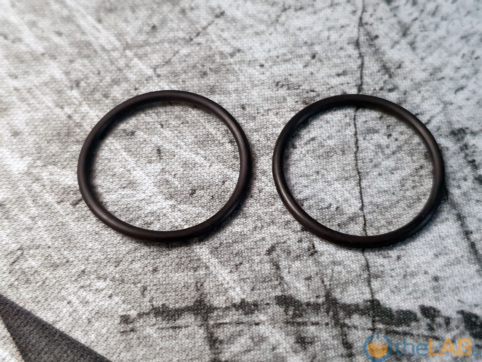

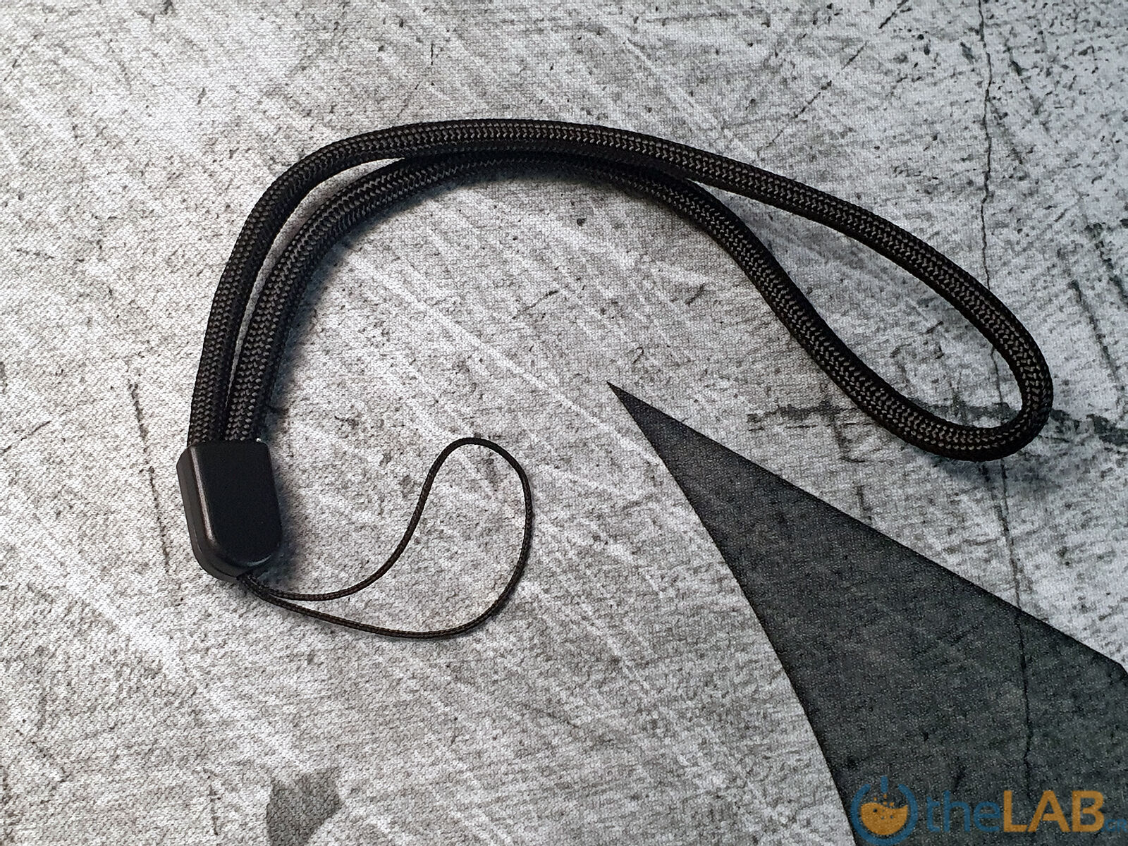

    The zip lock bag contains a lanyard and 2 spare O-rings.

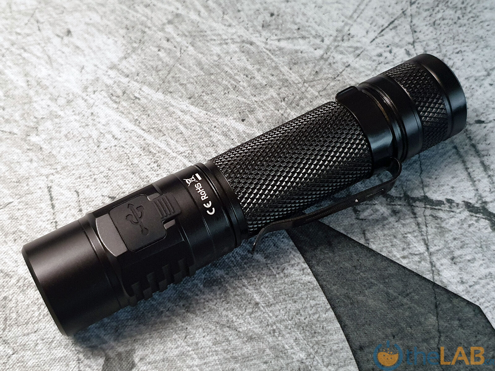

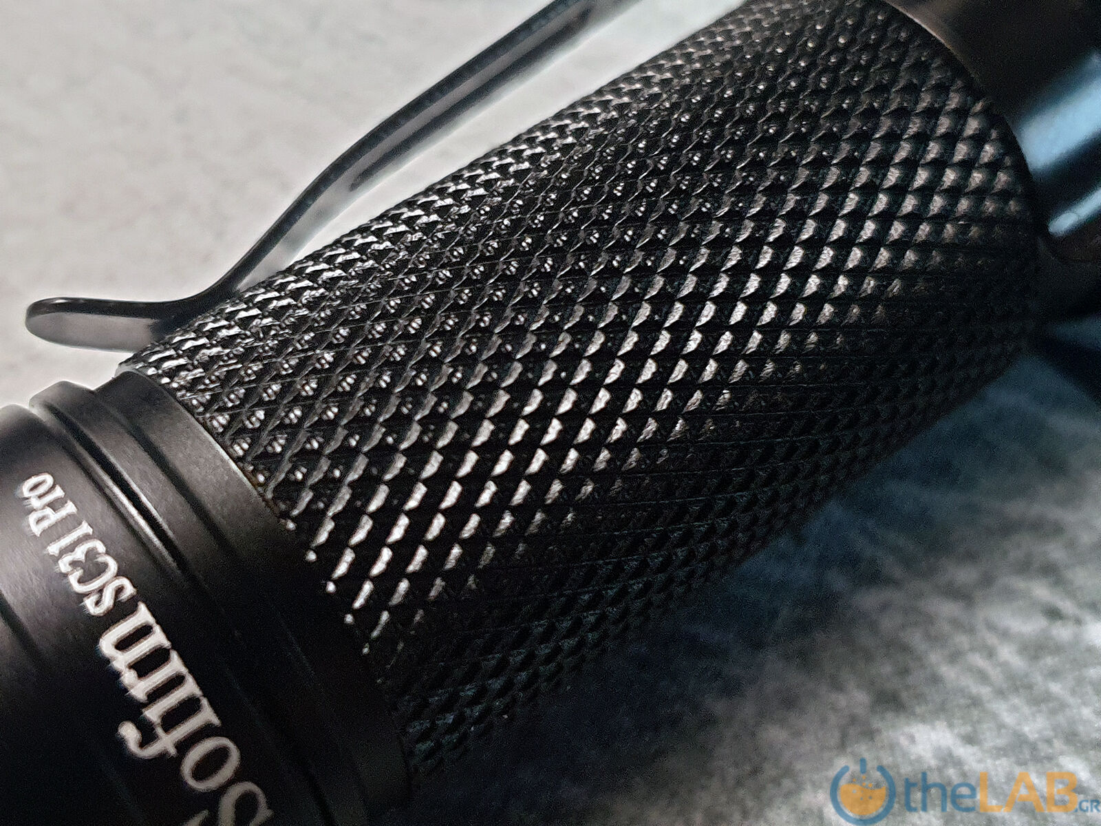

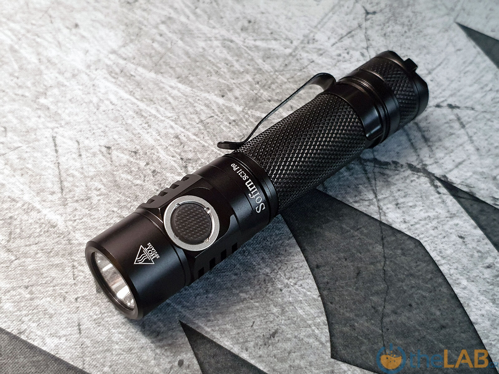

    The Sofirn SC31 Pro is made of aluminium with black anodization and has a side button and a pre-installed clip. The body has knurling, to make it grippy and the tailcap features a hole for the lanyard. The sides of the driver portion feature some small fins for heat dissipation. Everything is nicely finished and chamfered, except for the lanyard hole and the fins that are somewhat sharper, but not much.
    On the opposite side of the button there is a rubber cover and under it, a USB type C charging port.

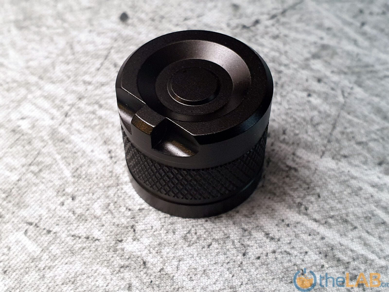

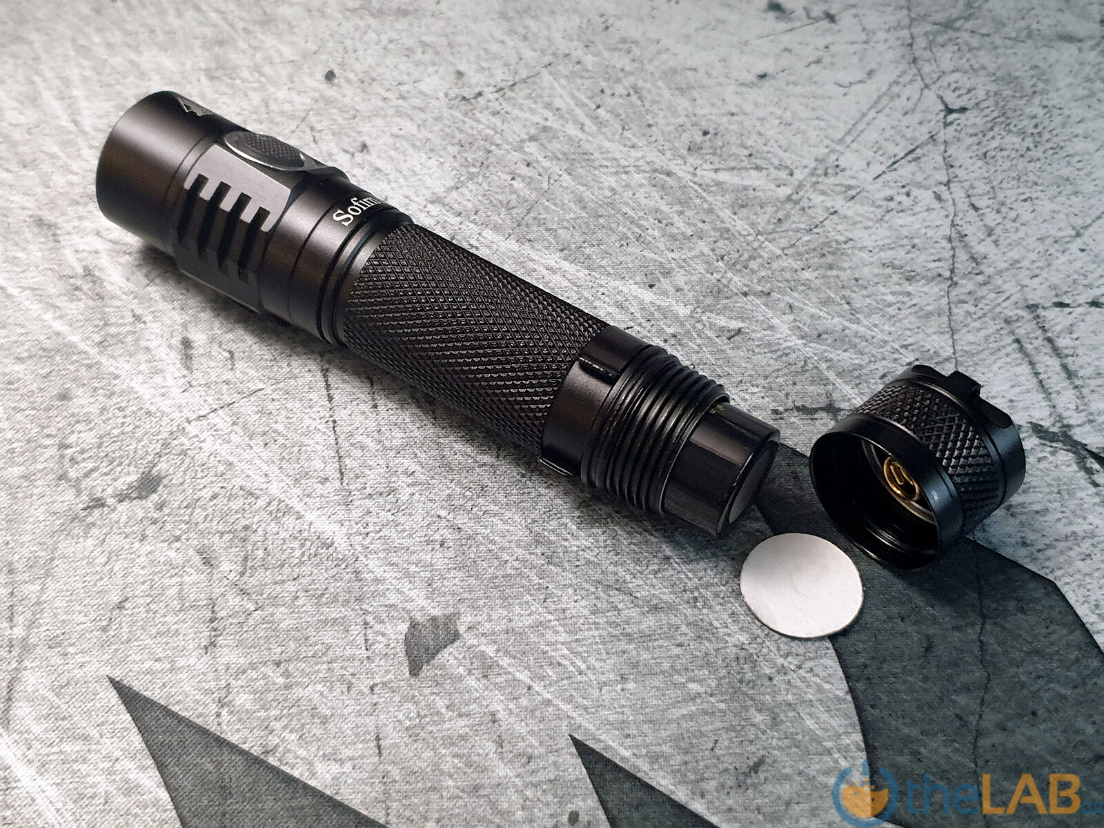

    The tail cap has some knurling that helps to grip it and screw it on or off. The battery ships inside the light but an insulator prevents it from touching the negative spring so the light cannot be activated during shipping. The threads are square cut and come nicely greased. They are anodized, so even a slight unscrewing of the tail cap will break electrical contact and mechanically lock the light.
    The included battery is a Sofirn branded button top 18650 with a capacity rating of 3000mAh.
    The battery tube can unscrew from the torch head also. This allows it to be replaced with the optional Sofirn 18350 Short Tube, available on the Sofirn website for $1.49.
    There are springs on both the tail cap and the head of the torch, ensuring compatibility with different length 18650 batteries and also the continuity of the circuit during drops and bumps. The springs are thick and of high quality. They are more than adequate for the current this torch draws.
    The included tail cap has a lanyard hole (which could have smoother corners) and is not magnetic. An optional, Sofirn Magnetic Tailcap is available at the Sofirn website for $1.69.

    The build quality of the Sofirn SC31 Pro is surprisingly good - for the price point and feature set - and on par with other Sofirn lights.
    The fit and finish is excellent, the knurling is of good quality and the anodization is without any flaws.
    There are a couple of somewhat sharp edges - specifically on the fins and the lanyard hole - and the 2 indicative LEDs on the switch (which can be turned off or set to blinking mode through the Andúril UI) are not quite aligned, which is a perfectionist's nightmare, but these are details that would raise the cost and can be considered acceptable at this price point.

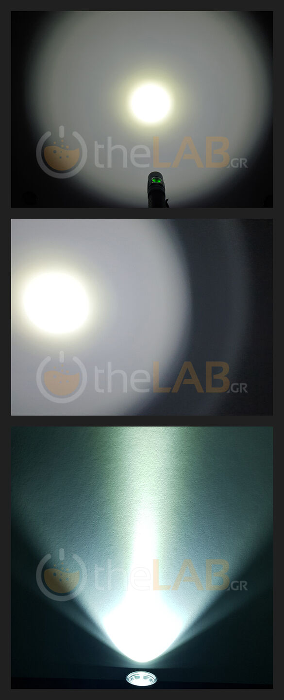

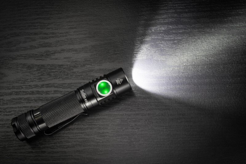

    The beam pattern of the Sofirn SC31 Pro is a product of the LED type and size and the reflector it uses. With the 5x5mm SST-40 and a smooth reflector, it is not surprising that the result is a somewhat tight hot spot that throws nicely, surrounded by a nice, usable spill. All in all, a very balanced and usable EDC beam pattern.
    There are various rings and coronas that are typical of smooth reflectors and may annoy white wall hunters, but those are unavoidable with smooth reflectors and the smooth reflector is what is giving the Sofirn SC31 Pro a very nice throw.
    I tested the Sofirn SC31 Pro over a distance of 70m, which is more than adequate for an EDC style torch.

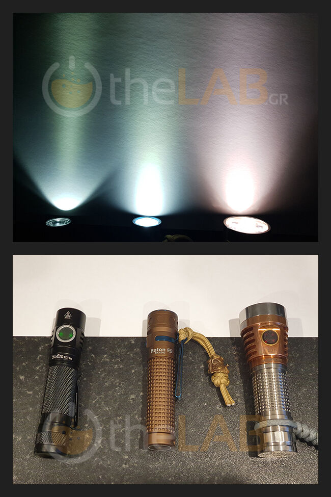

    The tint of the Sofirn SC31 Pro is the cool, greenish (above BBL) tint that is expected of the Luminous SST-40 emitter. It is very similar to the tint of the Olight Baton Pro. Next to them, for reference, the Fireflies E07 with Nichia 219b sw45k emitters which are high CRI and very rosy (below BBL). The SST-40 used is not high CRI.

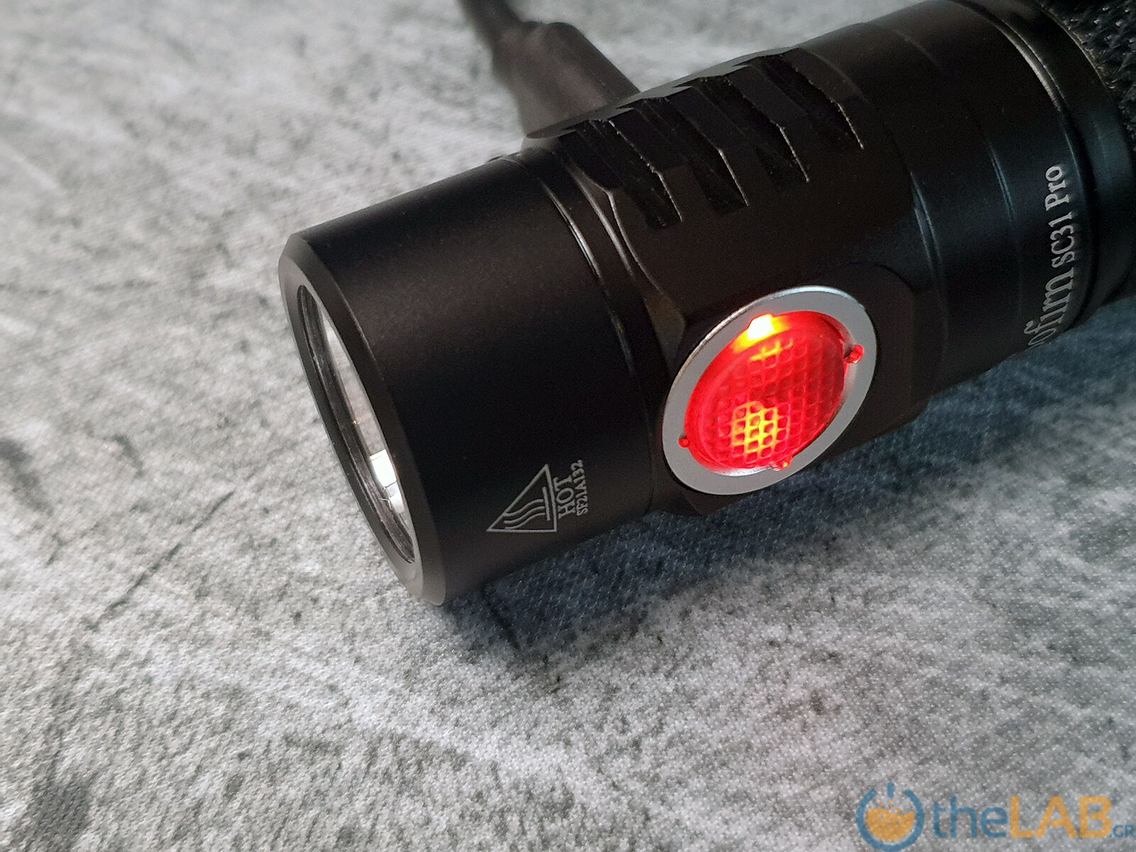

    Charging the Sofirn SC31 Pro is very easy. Just lift the rubber cover and insert the provided USB type C cable to charge the light.
    The indicative LEDs on the switch turn red to indicate the light is charging. They turn green when the charging is completed, at 4.16V.

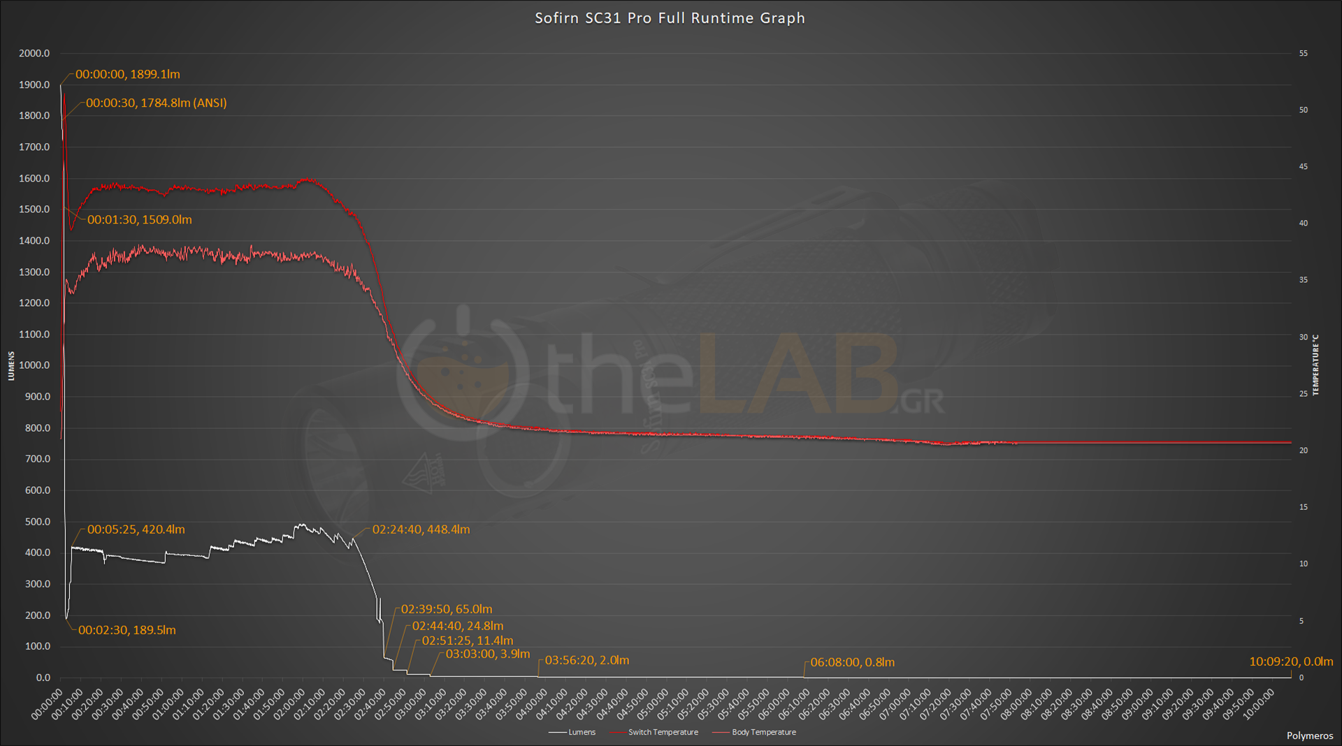

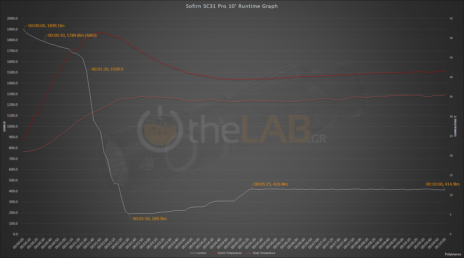

    The Sofirn SC31 Pro is rated at 2000 lumen output and 200m of throw. I measured it at 1899 lumen at turn on (Turbo), 1785 lumen ANSI (30sec), while throw actually exceeded the specs by 10% and measured at 220m (12108cd).
    The temperature was very well controlled, as you can see in the runtime graphs below. Turning on the light at Turbo, will cause a rapid rise in temperature, followed by a huge dip in output, while the temperature stabilizes. This can be avoided if the light is not on Turbo, but used at a more moderate output level.
    The light was temperature calibrated, according to the manual, and the temperature limit was set at 50C. The actual temperatures on the button and on the body of the light did not exceed 51.5C and 38.2C, respectively.
    All in all, the Sofirn SC31 Pro gave very usable light for about 2.5 hours, when turned on at Turbo, which is very respectable. Usage at more moderate levels, will of course, result in higher runtimes and lower, if any, output dips, due to temperature management.
    The Full and 10' runtime graphs tell the story in great detail. All significant changes in output are marked.
