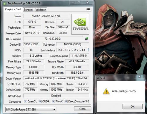

FrOsT Posted January 22, 2012 #13 Share Posted January 22, 2012 Link to comment Share on other sites More sharing options...

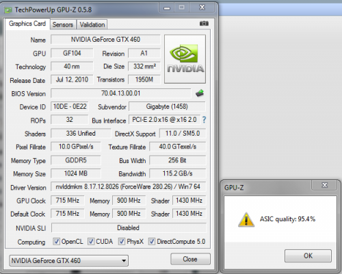

antonis Posted January 22, 2012 #14 Share Posted January 22, 2012 Gigabyte Gtx 460 Link to comment Share on other sites More sharing options...
