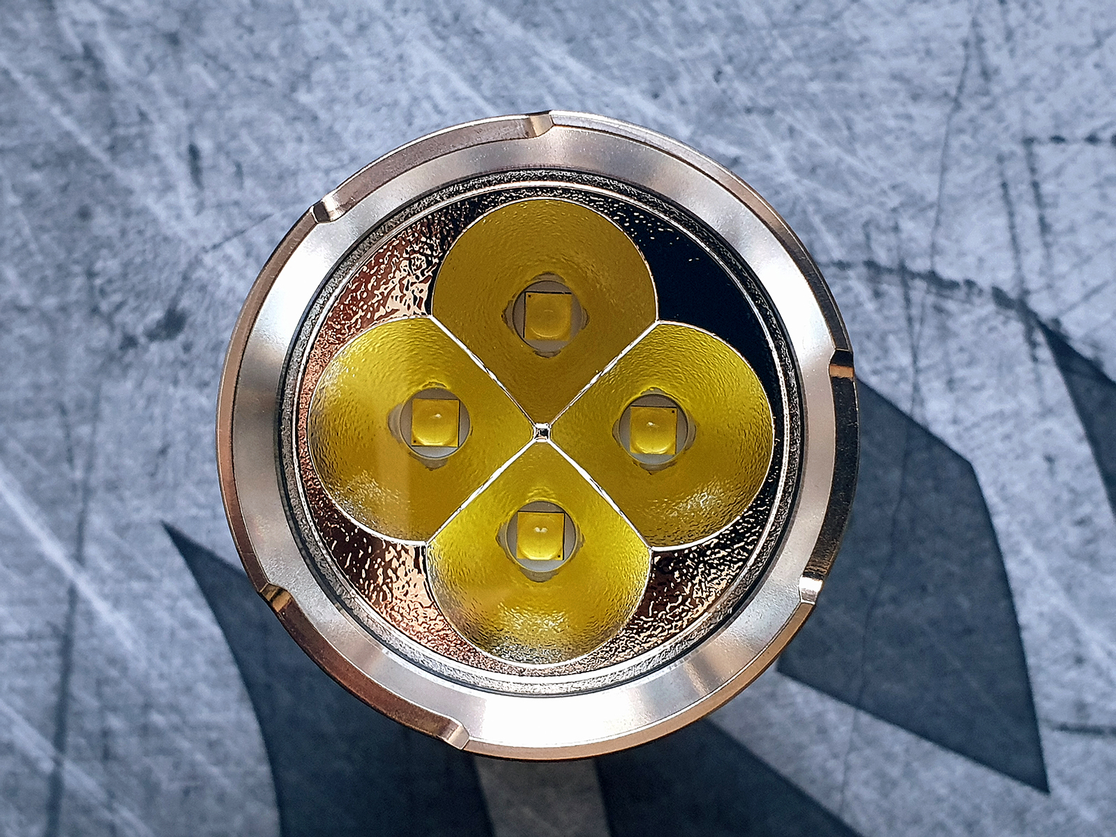

That is even more true about the business end of the light, which features a quadruple orange peel reflector with deep enough cups to add a bit of throw. The emitters at the bottom of those cups are 4 Cree XHP50.2 6500K LEDs.

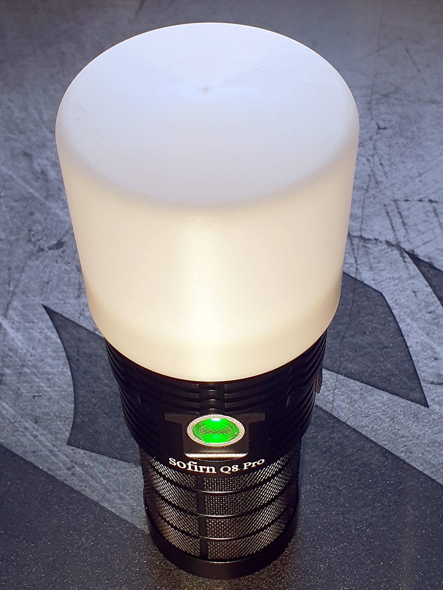

The diffuser is plastic and fits on top of the torch when it tail stands, but is loose and will fall if the torch is lifted up and tilted. It can also break if it is dropped. I would definitely prefer a silicone diffuser.

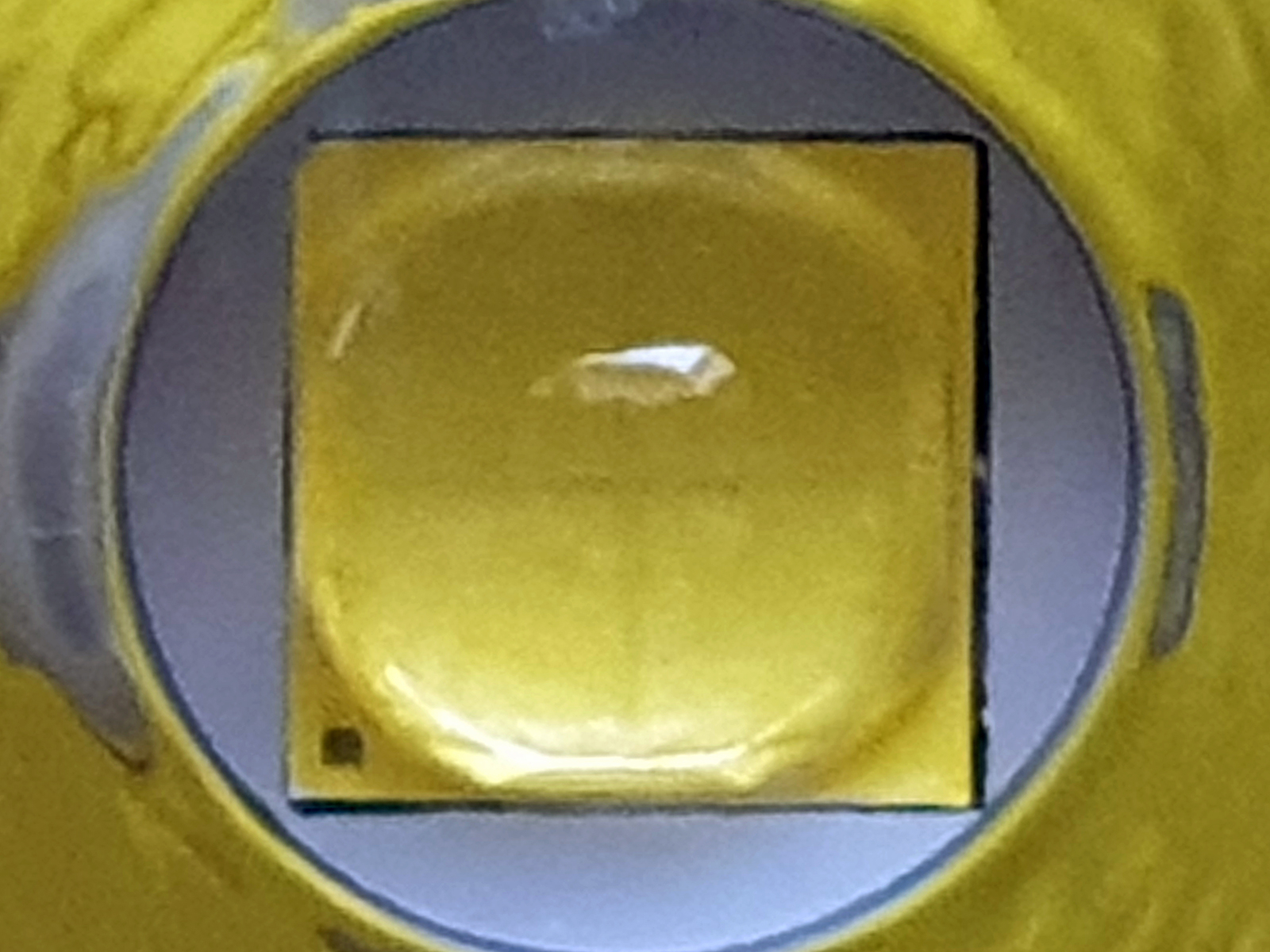

The torch features 4 Cree XHP50.2 emitters with a CCT of 6500K (cool white - there is also a neutral white version at 5000K) which provide a maximum output of 11000 Lumen and a maximum throw of 400m. It is powered by 4x 3000mAh 18650 Li-Ion batteries, is USB C rechargeable and incorporates a power bank function.

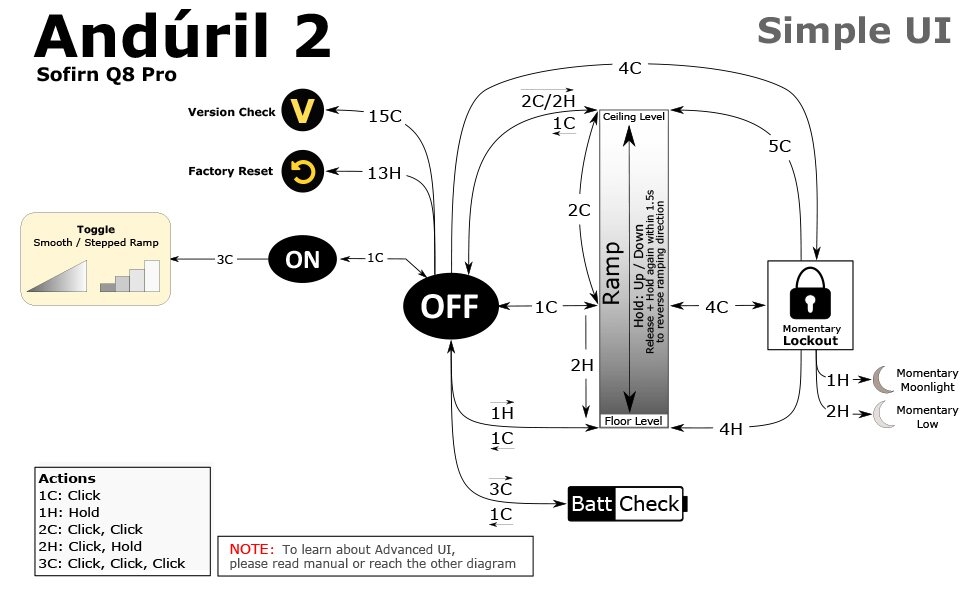

The user interface of the Sofirn Q8 Pro is a love or hate deal, as the light features the Andúril2 UI. Personally, I love it and deeply enjoy the fact that it is feature packed but still provides simple, quick and intuitive access to the basic functions. Others hate it and consider it too much work, as the manual is extensive and even the flow chart found at the company's website can be intimidating to look at.
Andúril2 offers a Simple UI, which the torch comes set to, that allows for all the basic functions, while remaining relatively simple.
10 clicks and hold the last, and you enter the magical realm of the full Andúril2 experience. Give it a chance! You will love it!
In my experience, after the initial shock, it is very easy to start using Andúril2 and have an occasional look at the flow chart to remind oneself of the more advanced functions.
An important thing to do when you take any Andúril2 light out of the box is to perform a temperature calibration, as the light will depend on it to perform proper thermal control and balance brightness with temperature. That is also the best time to set the temperature limit. I find 50°C to be a good temperature limit and the tests done in this review were done on a calibrated light and with a 50°C temperature limit.

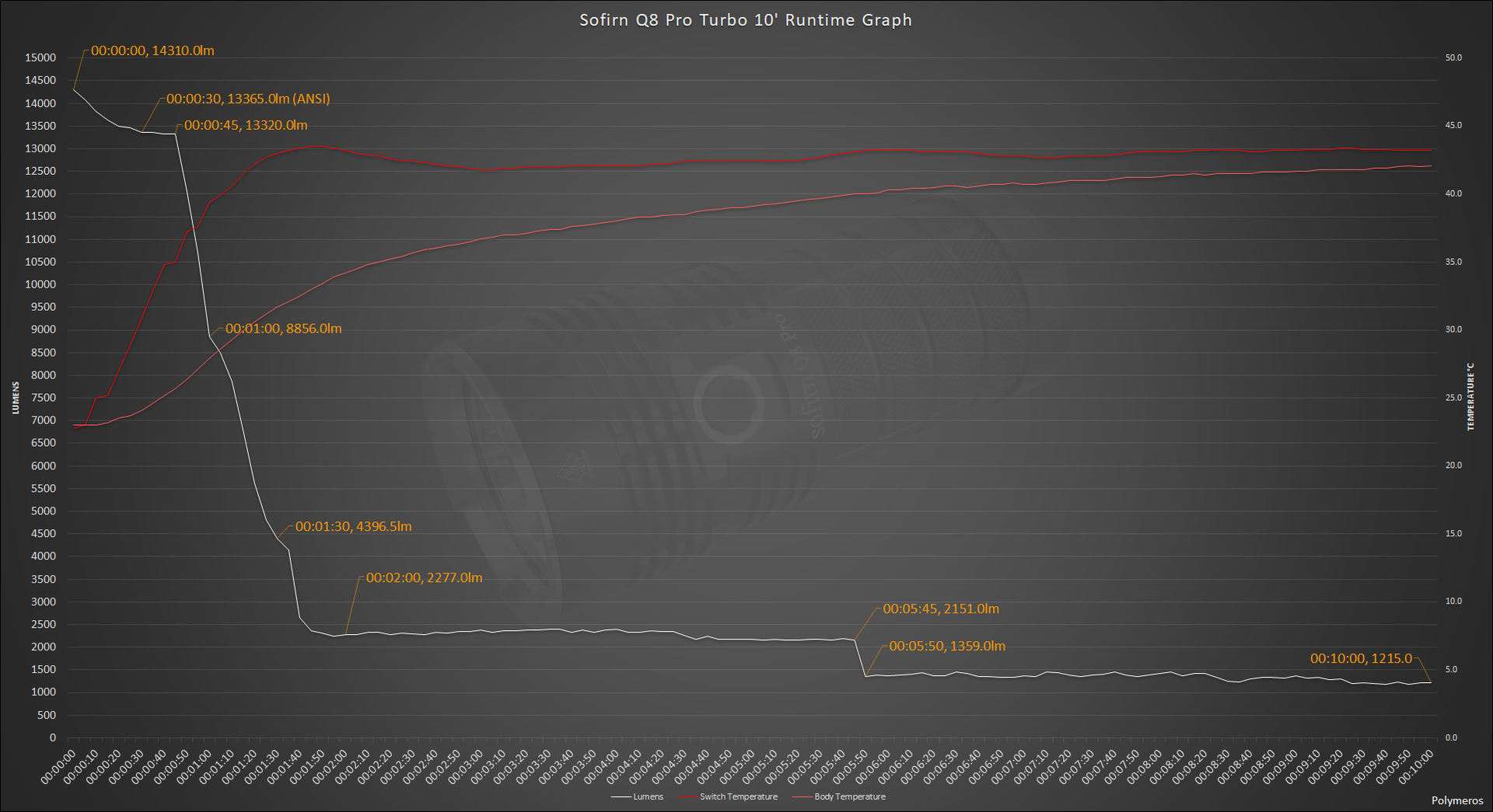

The rest can be seen in the graphs below. The first graph is the full runtime graph that my equipment can record with a sampling interval of 5 seconds. At 29 hours, 9 minutes and 55 seconds, the Sofirn Q8 Pro was still on, with an output of 0.5 Lumen.
Most of the action happens in the first 5 hours though, so here is a graph that shows that part of the runtime in greater detail.
And here are the first 10 minutes.
The temperature was very well controlled, as you can see in the runtime graphs. The head and body temperatures are very close, which shows the excellent thermal conductivity of the torch.
The torch was temperature calibrated, according to the manual, and the temperature limit was set at 50C. The actual temperatures near the button and on the body of the torch can be seen on the graphs and were kept well within the set limit.
All in all, the Sofirn Q8 Pro gave outputs of over 1000 Lumen for over 3 hours and 40 minutes, when turned on at Turbo, which is very respectable, especially considering the very high initial output. Usage at more moderate levels, will of course, result in higher runtimes.
