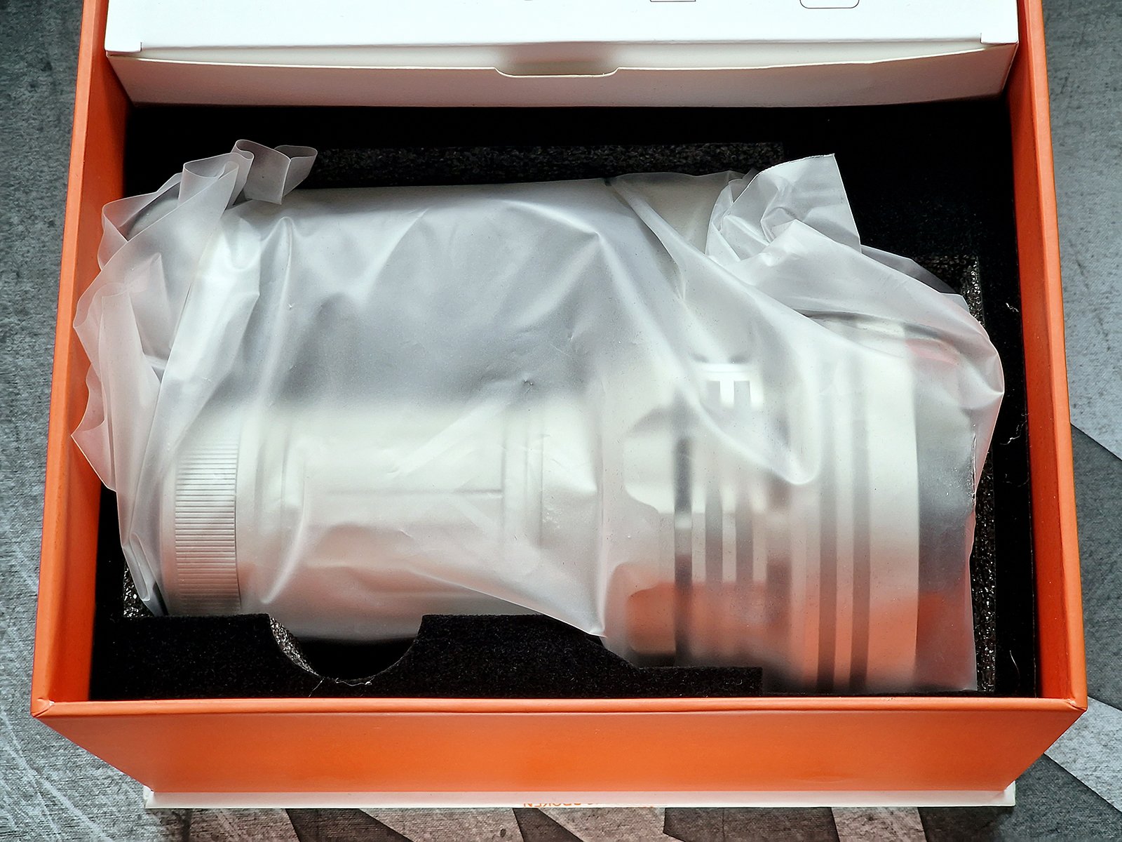

    The box closure is magnetic. Upon opening it, you are greeted with a lot of packing material, protecting the torch, a yellow card and a white box. You can already glimpse that the torch on the left is black while the torch on the right is white.

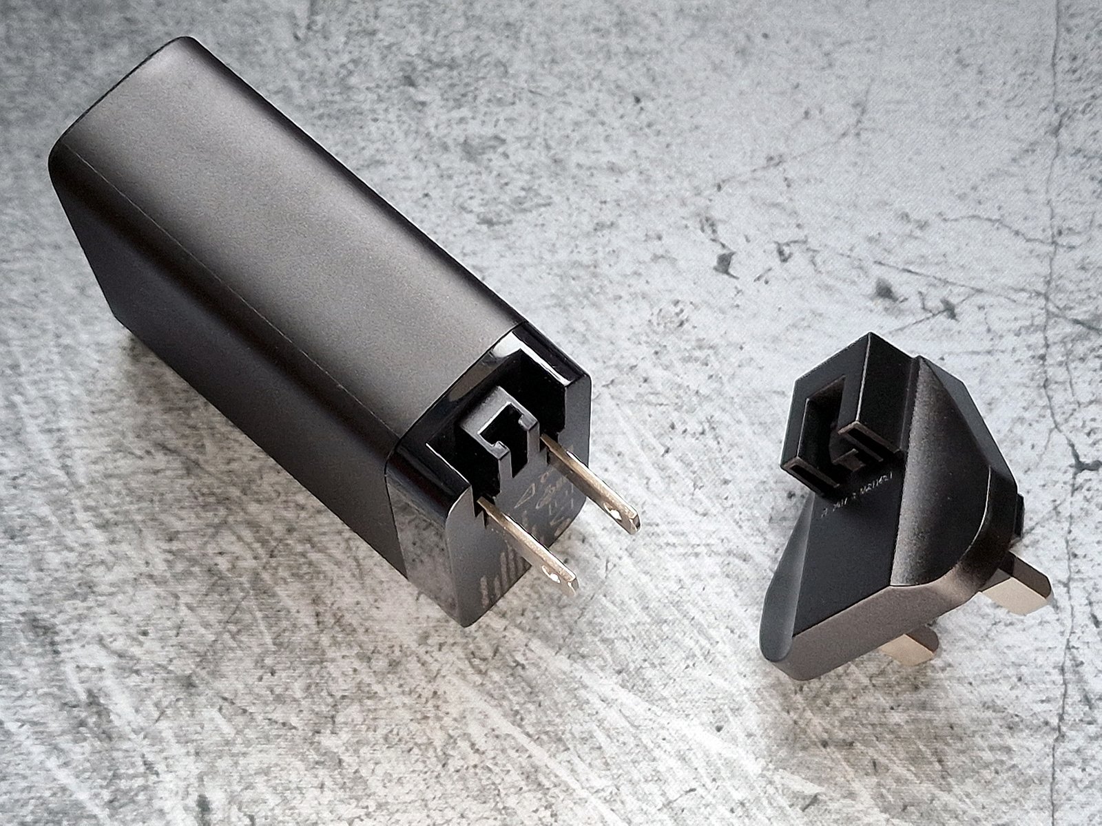

    The foldable prongs are compatible with US power outlets. UK or EU adapters can be applied and are provided, according to the region of the buyer.

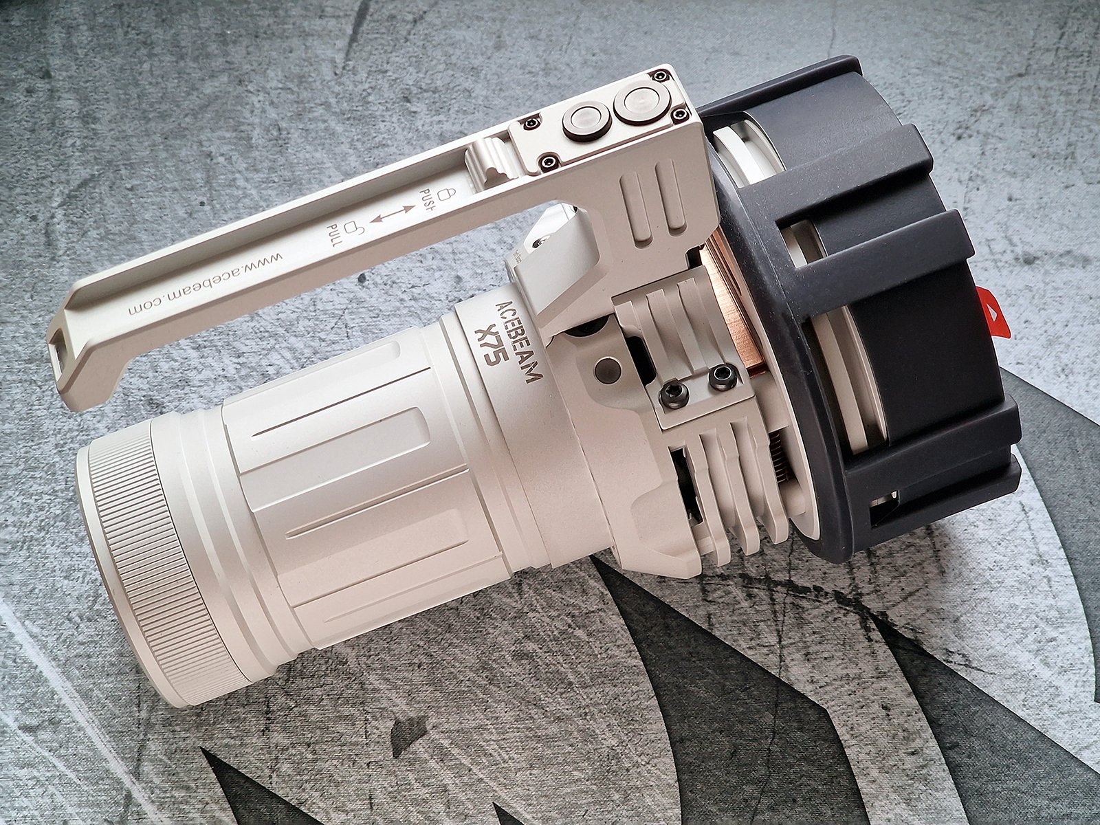

    The black Acebeam X75 comes with the silicone cover installed while the white (MAO) one comes in a protective nylon bag, without the silicone cover, which as we saw is in the accessory box.
    Let's take the torches out and install the silicone cover on the white one as well.

    Let's remove the silicone covers to really show off the beautiful design of the Acebeam X75.
    The crenulated bezel is made of stainless steel and is black in both finishes. So are the buttons and the screws. Everything else is made of Aluminium and is either black or off-white, depending on the chosen finish. The head is thicker than the battery tube and the deep fins provide cooling surface.
    There are openings all around the head to allow for air flow, as there is a cooling fan and a copper heat sink inside the torch!
    The handles feature 2 operation buttons and a Mechanical Lock switch.
    There are airflow holes at the rear of the head as well. Opposite the handle, there is a UNC 1/4" socket for mounting the Acebeam X75 on a tripod.

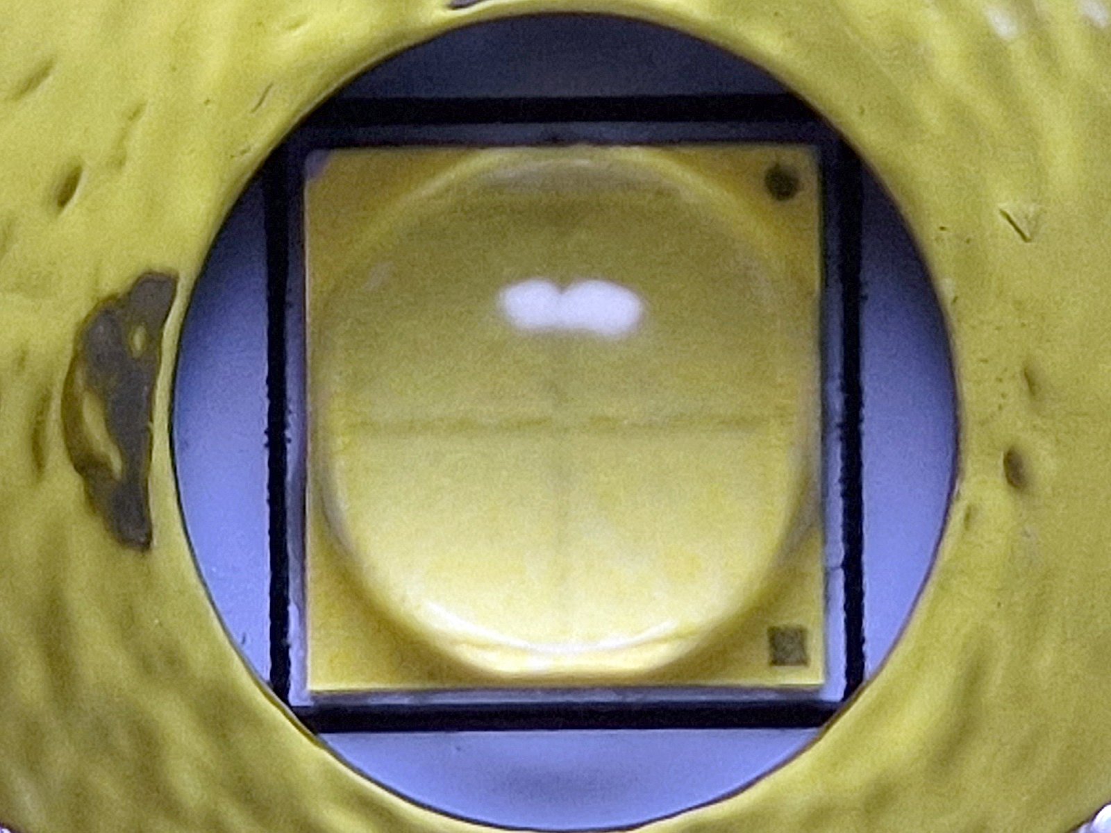

    The 1st photo shows one of the Cree XHP70.2 6500K emitters that are in the black sample and the 2nd one of the Cree XHP70.3 HI 6500K emitters that are in the white sample. As you can see, both are 4 die emitters, which makes the Acebeam X75 a 48 LED die torch! The Cree XHP70.2 is a domed emitter while the Cree XHP70.3 HI is dome-less and has a smaller die area, which explains both the lower brightness and the higher intensity (and therefore throw).

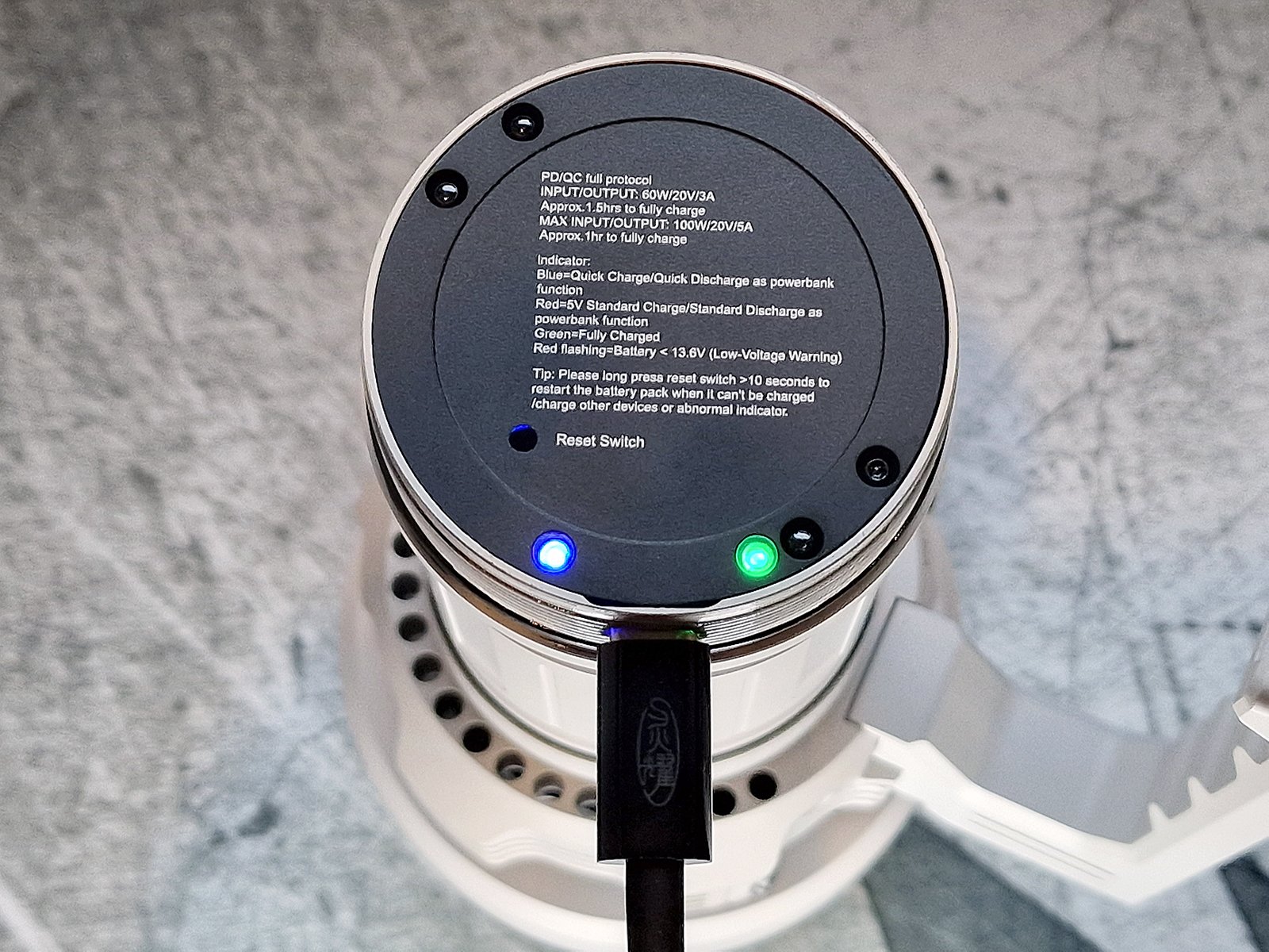

    Under the tail cap there are written specifications and instructions, 2 indicator LEDs and a recessed reset switch.
    The USB C port is on the side, inside the threads of the tail cap.
    Although I can see the simplicity and reliability of this design, I do not like it. The tail cap feels too generic and non-luxurious when removed, especially when compared with the high end feeling of the Acebeam X75 in general. But the real issue is practical. Not only can the tail cap be damaged or lost, but also the grease in the threads got on my hands and smeared everything a few times before I got used to the notion and became mindful enough. A tail cap system such as the ones used in the Olight X7R or Olight Marauder 2 would have been nicer. An exposed, water proof USB C port, such as the ones used in high end mobile phones would have been even better.

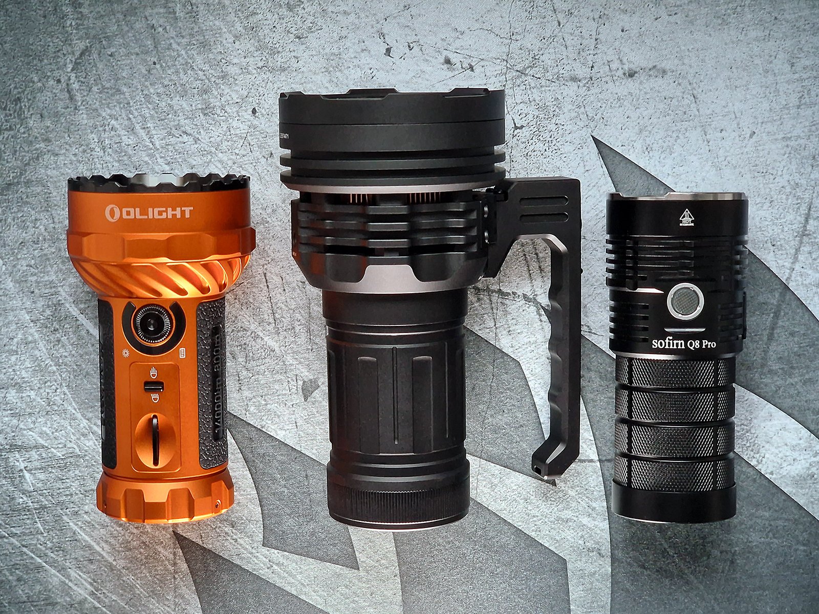

    The Acebeam X75 is on the large end of the spectrum for soda can type torches. There are of course much larger torches out there and taking into account its Lumen output, the Acebeam X75 is quite compact for the power it packs. That said, it is by no means a torch you can put in a large jacket pocket.
    Here is the Acebeam X75 between the Olight Marauder 2 and the Sofirn Q8 Pro.

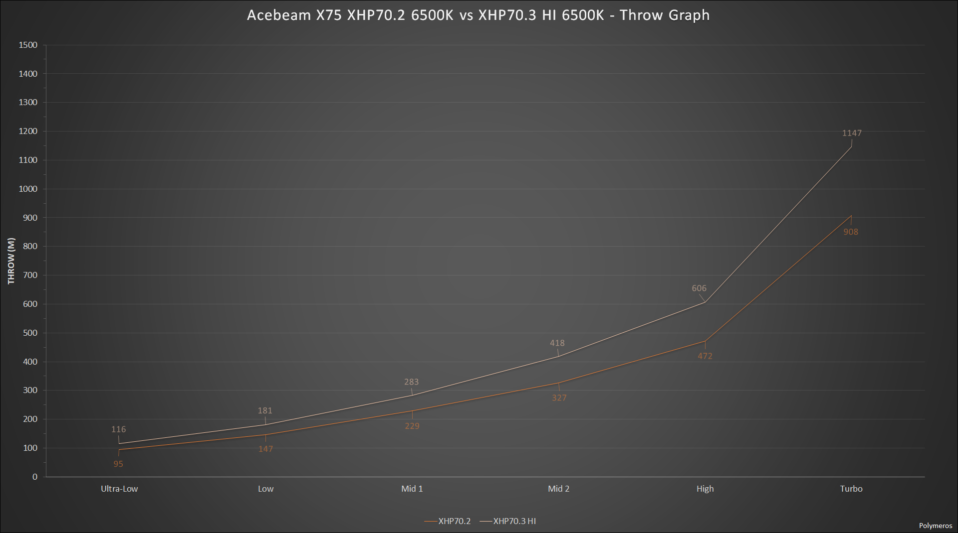

    The output levels of the Acebeam X75 can be seen in the following table. The numbers provided by Acebeam are in black and my measurements are in orange.
    I do not own a multi thousand dollar worth integrating sphere, just a logging Lumen meter and a home made integrating tube. The array is calibrated with 3 separate, professionally measured lights and gives me consistent results, but there is definitely room for error and deviations are to be expected.
    My Lumen measurements show that the Turbo output of both emitter types do not reach the specs but are still very impressive. The Cree XHP70.2 6500K are up to or even slightly above specs in Lumen output on all modes except Turbo. The Cree XHP70.3 HI 6500K have lower Lumens output than specs on all modes. It seems like Acebeam just copied the lower mode numbers from the Cree XHP70.2 6500K specs but of course the Cree XHP70.3 HI 6500K will be a bit lower.
    The Candela and Throw I measured are also lower than specs in all modes, but again impressive for these floody beams. The Cree XHP70.3 HI 6500K is the stronger emitter in this category.
    The following graph shows the lumen output on all modes for both emitters. The Cree XHP70.2 is more powerful on all modes.
    And this graph shows the throw on all modes for both emitters. The Cree XHP70.3 HI throws further on all modes.
    So, what will you choose, Lumen output or throw? For me, both emitters have more than enough of both. It is just a matter of which feature you favour the most.

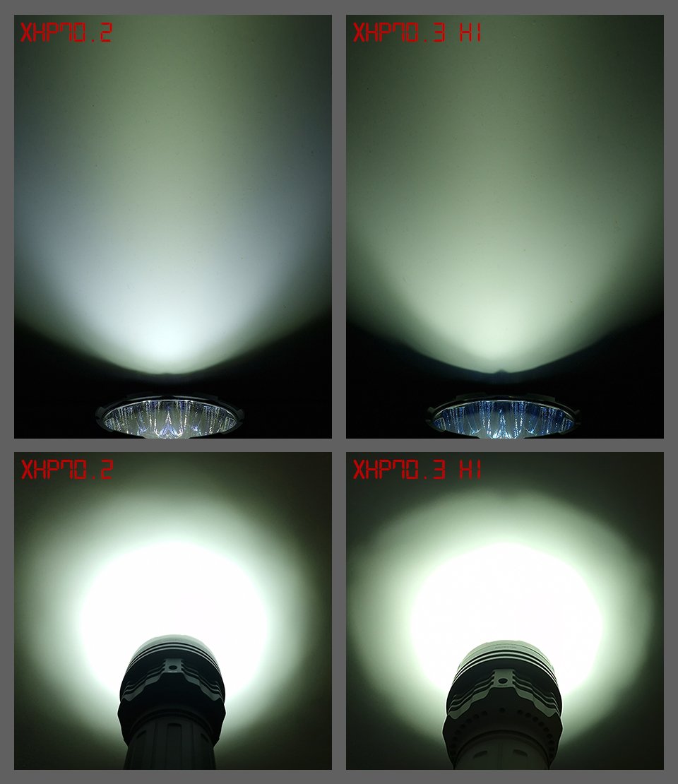

    Beam Profile

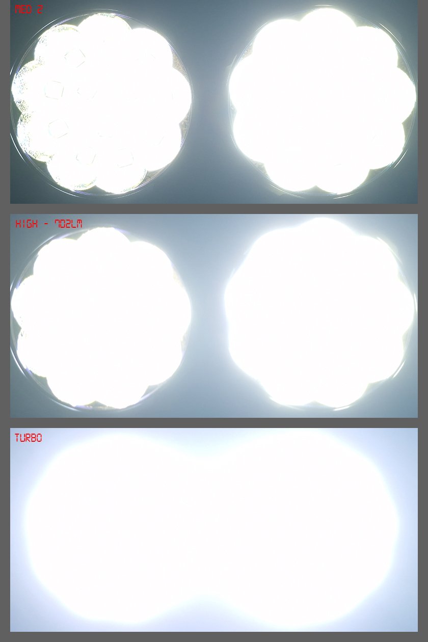

    The beam pattern of both emitter types in the Acebeam X75 is very floody but there is a definite, albeit small difference in intensity and beam angle.

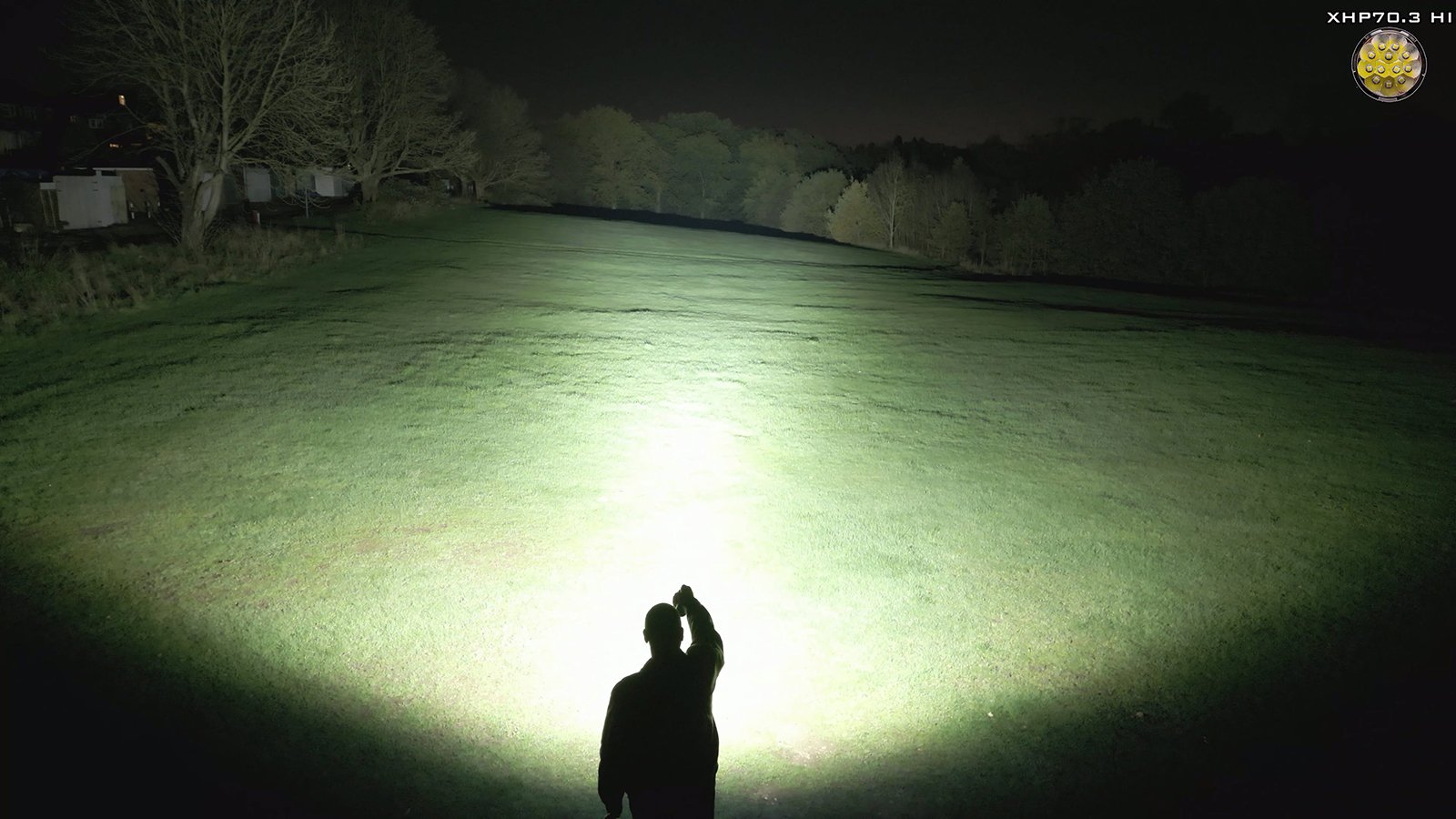

    Video Comparison - Drone footage
    For the video comparison of the Cree XHP70.2 versus the Cree XHP70.3 HI version of the Acebeam X75, I enlisted the help of the excellent photographer and videographer Daniel Beacock and his drone. We tested the two versions of the Acebeam X75 over distances of 191m and 470m.
    Here are some revealing frames from the video:

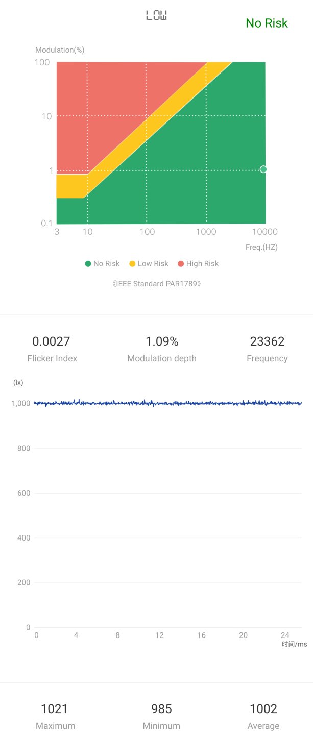

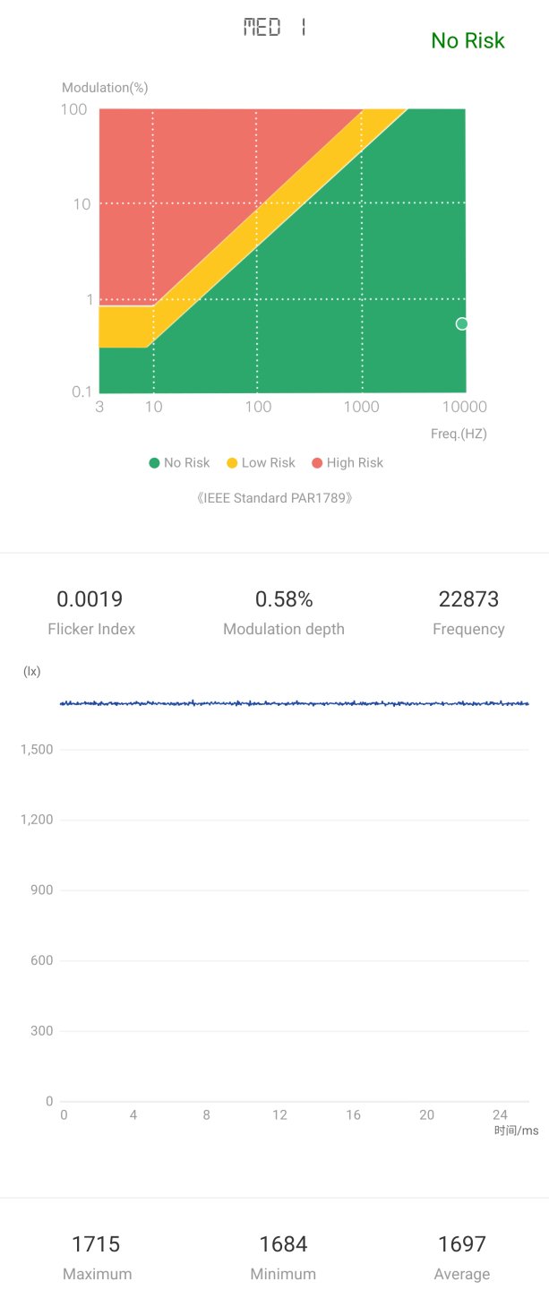

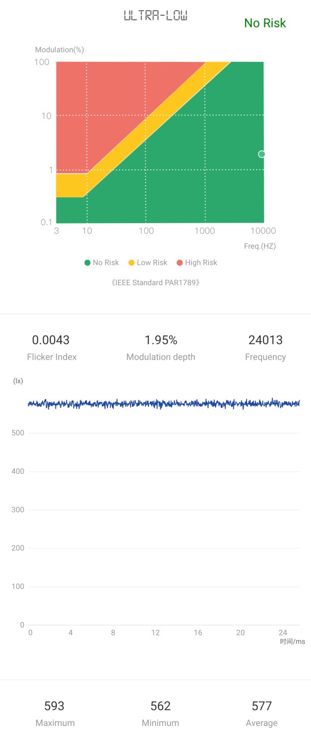

    The driver of the Acebeam X75 is a digitally regulated, constant current boost driver, which takes the 14.4V from the battery pack and delivers 24V to the emitter array. Both emitter types are 6V, so they are arranged in 3 parallel banks of 4 emitters in a row to work with the 24V that the driver provides. This arrangement should be able to maintain constant brightness regardless of the battery voltage. The driver also features smart temperature control. Large copper heatsinks and thermal pads provide the thermal path to the main copper heatsink. Very refreshing to see such a high quality driver.
    There is no PWM, detected or visible, in any of the modes.
    large.1691276011_01Flickering-Ultra-Low.jpg large.1267619101_02Flickering-Low.jpg large.53232183_03Flickering-Mid1.jpg
    large.1000407059_04Flickering-Mid2.jpg large.848802978_05Flickering-High.jpg large.1931621361_06Flickering-Turbo.jpg

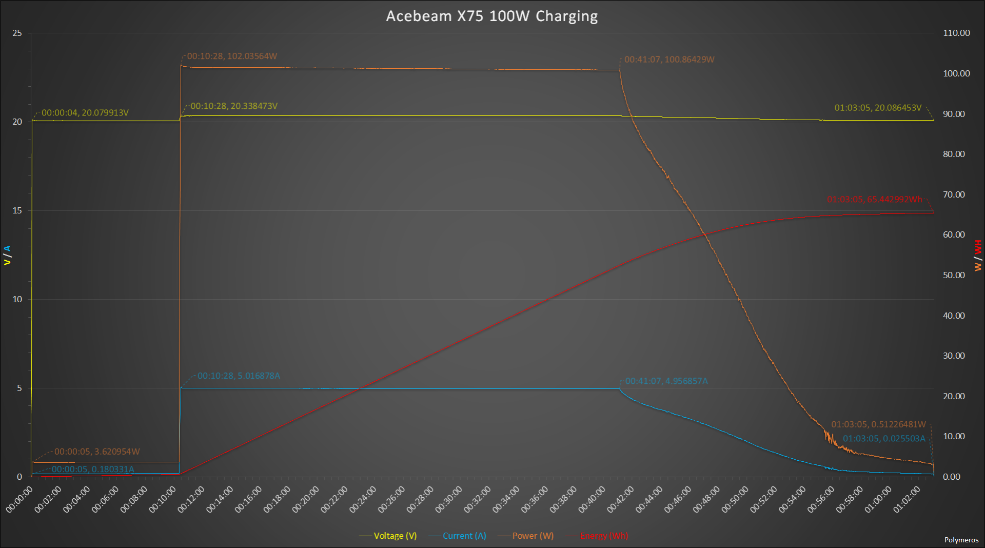

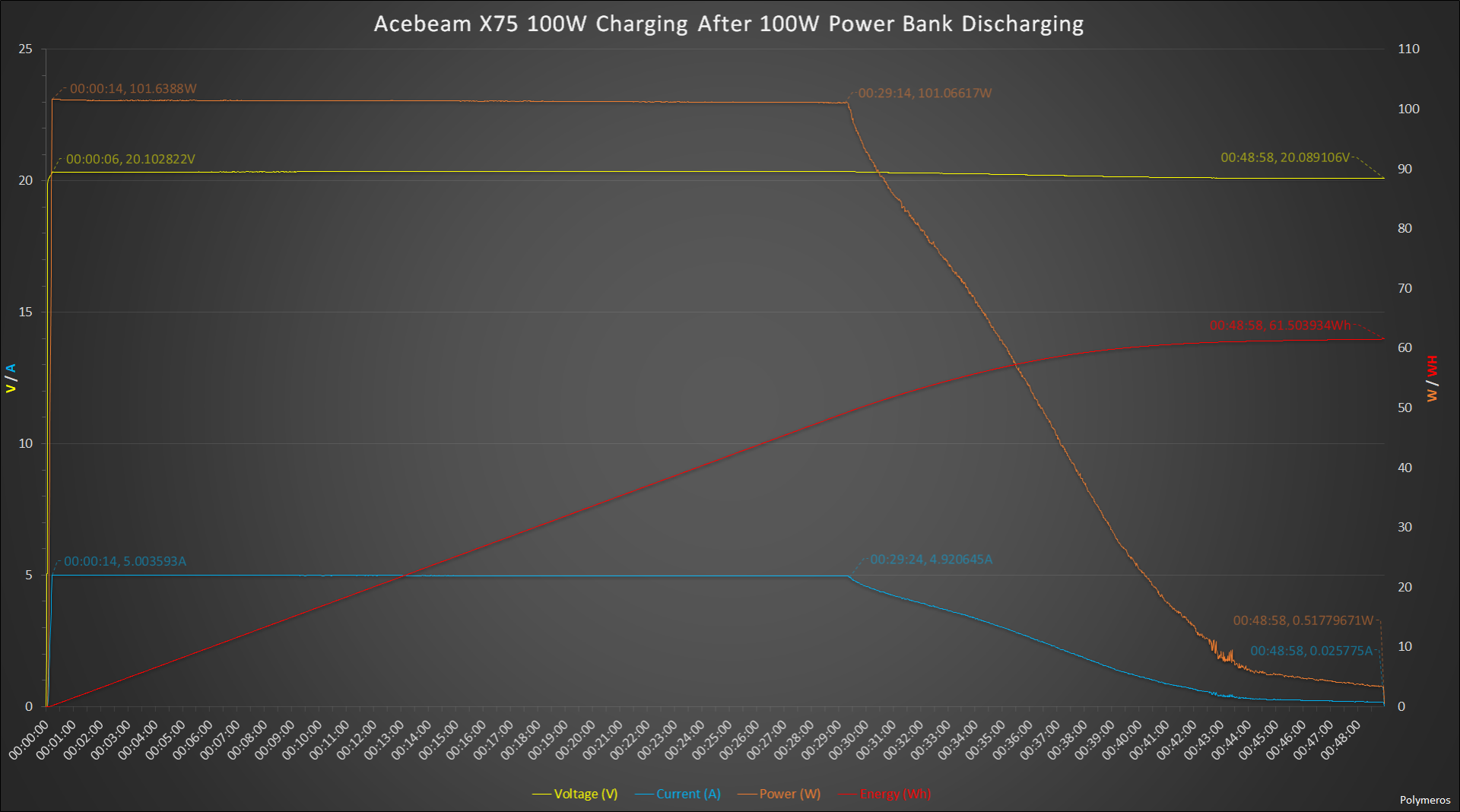

    Battery Pack and Charging
    The Acebeam X75 comes with a proprietary battery pack. This is unappealing for many users but necessary when you are dealing with this kind of configuration of 4 21700 high output batteries in series. The battery pack supports Power Delivery charging at 60W or 100W and also Power Bank functionality at the same power levels.

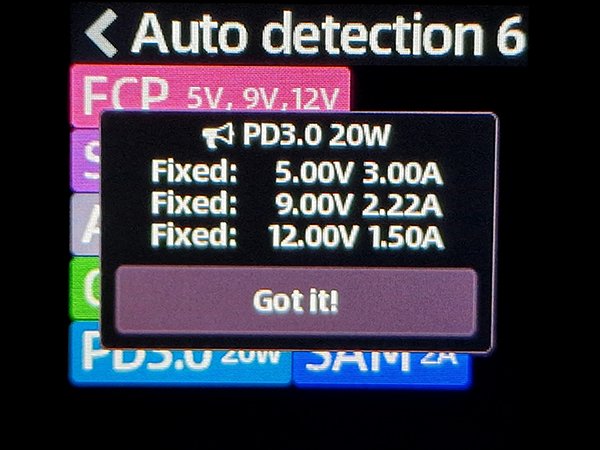

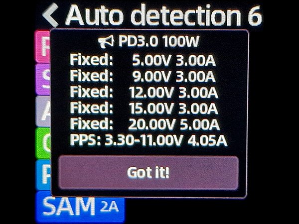

    The charger that comes as standard with the Acebeam X75 can provide 60W but it is possible to upgrade to a 100W charger for an added cost of $47.90. I opted to test the 100W charger. The supported modes are listed on the charger itself.

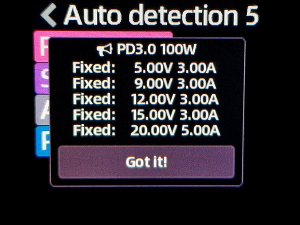

    Theoretically, C1 and C2 should be the same, but in reality they do not support all the same protocols.
    Here are the protocols supported by C1, C2 and C3 respectively.
    large.861576962_ChargerUSB-C1A.jpg large.1995940921_ChargerUSB-C2A.jpg large.1762383768_ChargerUSB-C3A.jpg
    And here are the Power Delivery output modes supported by C1, C2 and C3 respectively. Both C1 and C2 can be equally used to charge the Acebeam X75 at 100W but if you want to charge other devices, C2 supports the most protocols, including a set of PPS in Power Delivery.
    large.1821689866_ChargerUSB-C1B.jpg large.3797881_ChargerUSB-C2B.jpg large.934037683_ChargerUSB-C3B.jpg
    These are the modes supported (in green) by the USB A port.
    The cable provided is 1m long and of very high quality. It supports 100W (20V, 5A), as expected, but also supports transfer speeds of up to 20Gbps, which is a pleasant surprise.
    The specifications of the battery pack are shown in the table below.
    To charge it, you must remove the tail cap and plug in the USB C cable.
    The right indicator LED turns red to indicate charging. The left indicator LED turns blue to indicate that the Power Delivery protocol is being used.
    The right indicator LED turns Green to indicate that the charging is complete.
    The following chart shows the charging of the battery pack with the 100W charger, after it had been depleted completely to the point where the torch turned itself off at 11.62V. The charging starts at 3.6W for about 10 minutes and then jumps to 100W for about half an hour. Then it gradually declines until the charging is completed at a total charging time of about 1 hour. This charging process used a total of 65.44Wh while the battery pack is rated at 61.2Wh, which is very good charging efficiency. The voltage of the battery pack at the end of charging was 16.73V.
    When used as a Power Bank, the battery pack supports Power Deliver 3.0 up to 100W, with PPS.
    As shown below, it can provide power at 100W for about 30 minutes. The total energy provided in this scenario was 50.24Wh and the voltage of the battery pack at the end was 12.88V. This means that the battery pack was not completely depleted and could still operate the torch, at the lower levels, but it did not have enough power to be able to provide 100W output.
    The charging of the battery pack after it has been used in Power Bank mode as above is shown in the following chart. The charging took 49 minutes and used 61.5Wh. The efficiency of the battery pack as a Power Bank is therefore 50.24Wh / 61.5Wh = 82% which is very good.

    The most negative thing I have to say about the Acebeam X75 is the location of its charging port, which is under the removable tail cap and inside the threads. Even though this design is indubitably very robust in its simplicity, the removable tail cap feels less luxurious that the rest of the Acebeam X75 and it could be lost or damaged while removed. But the most important issue with the design is that having the USB C socket inside the greased threads caused me to smear the grease on my hands and subsequently all over the torch several times, before I got used to the idea and became mindful enough to avoid doing so.
