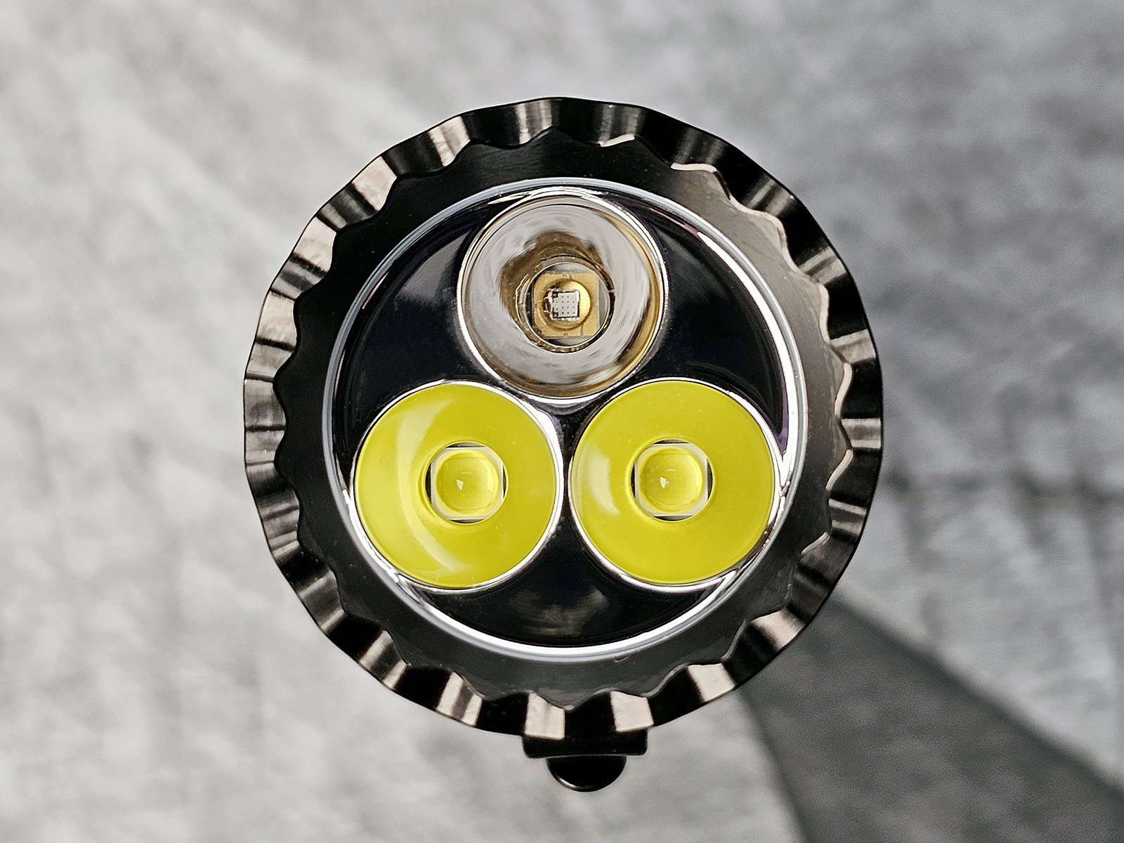

The Olight Seeker 4 Mini Ti is a torch that can output either white light or UV.
It is an EDC sized triple emitter torch, of which the 2 emitters are white and the 3rd is the UV emitter.

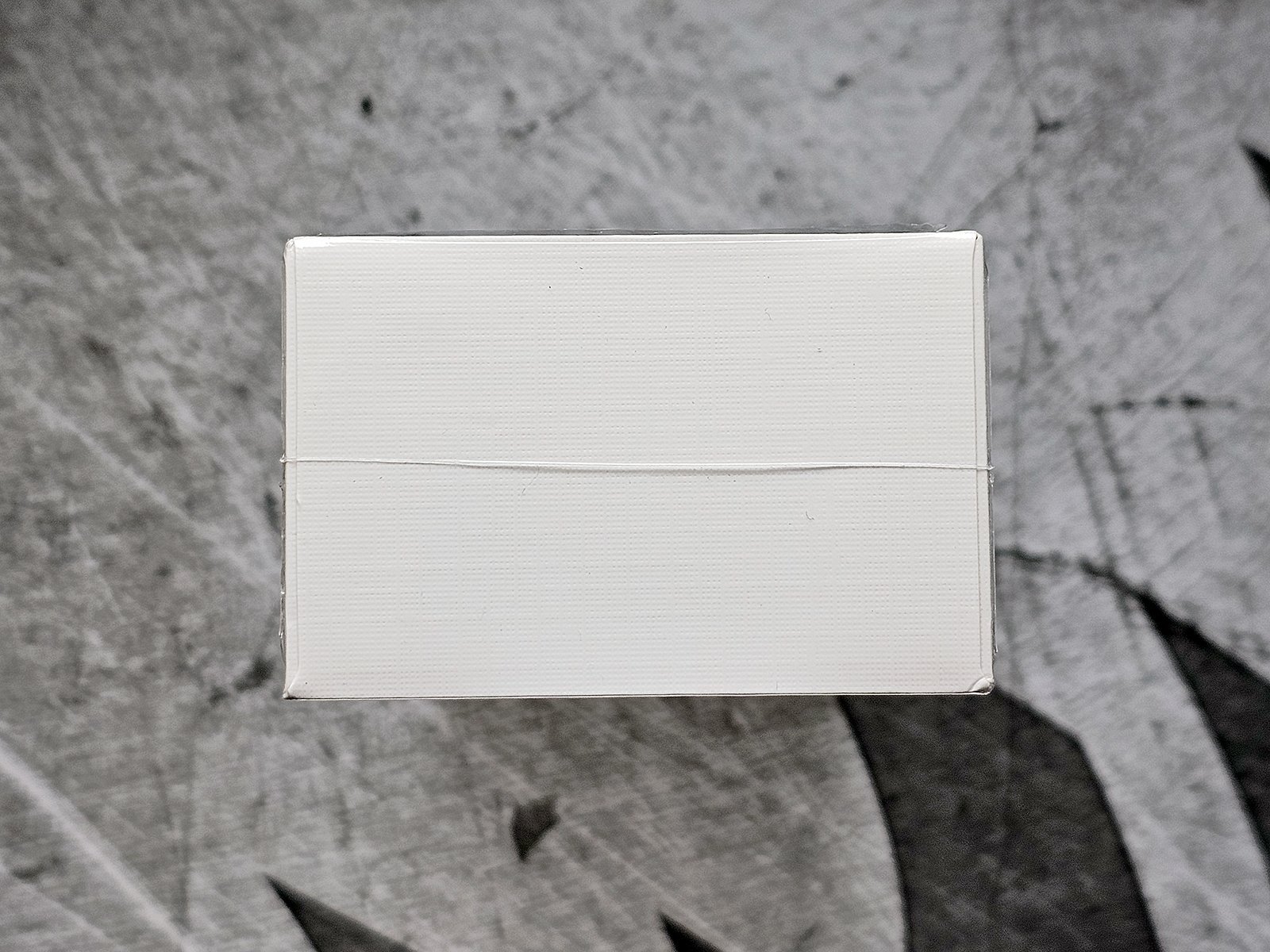

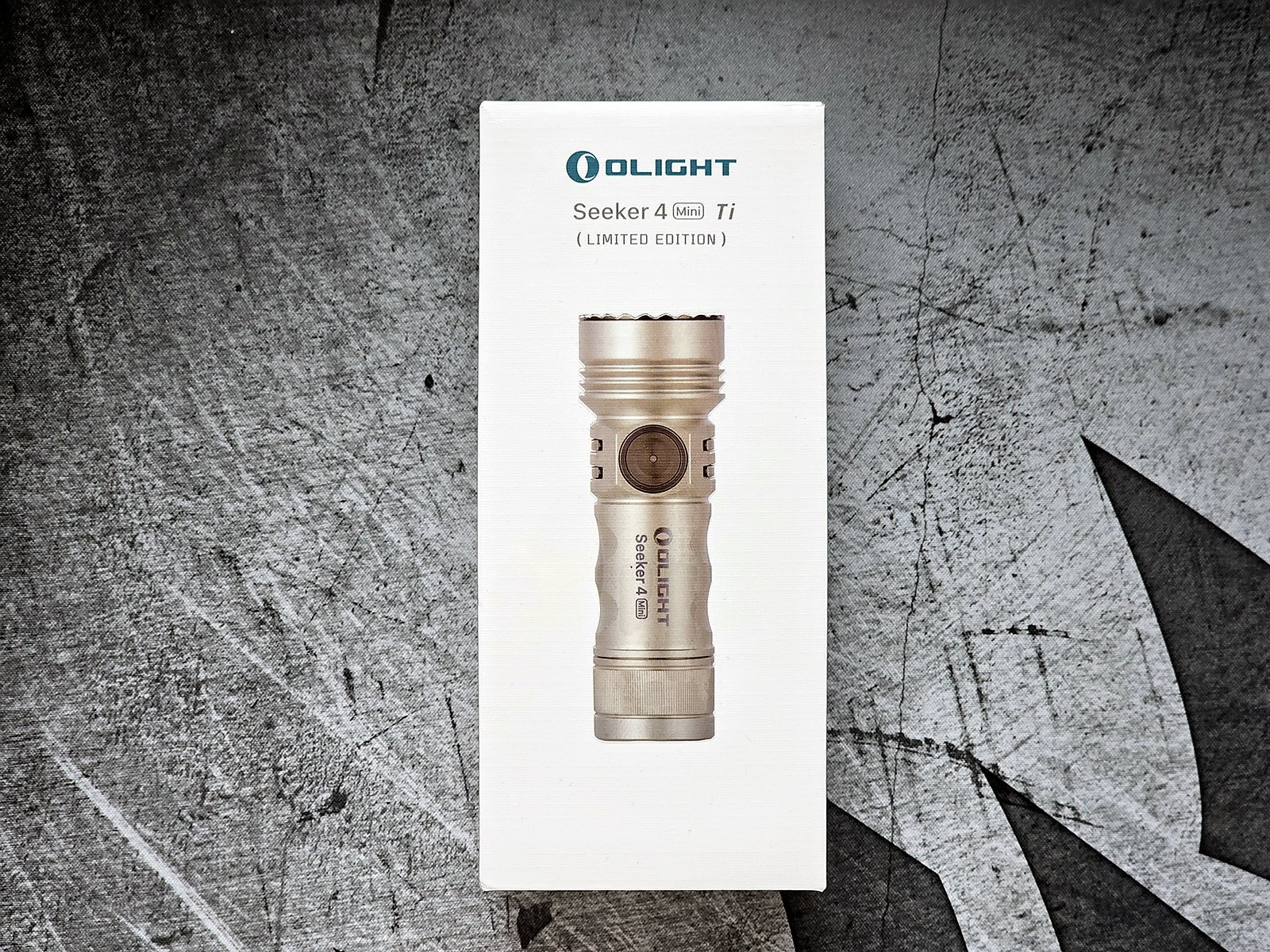

As with most Olight torches, the Olight Seeker 4 Mini Ti comes in a very premium looking box with excellent presentation.
Opening the box, you are greeted with a thank you and the instructions on how to remove the insulating film from the battery to allow for normal operation and charge the torch. The film is there to prevent accidental activation of the light during shipping.

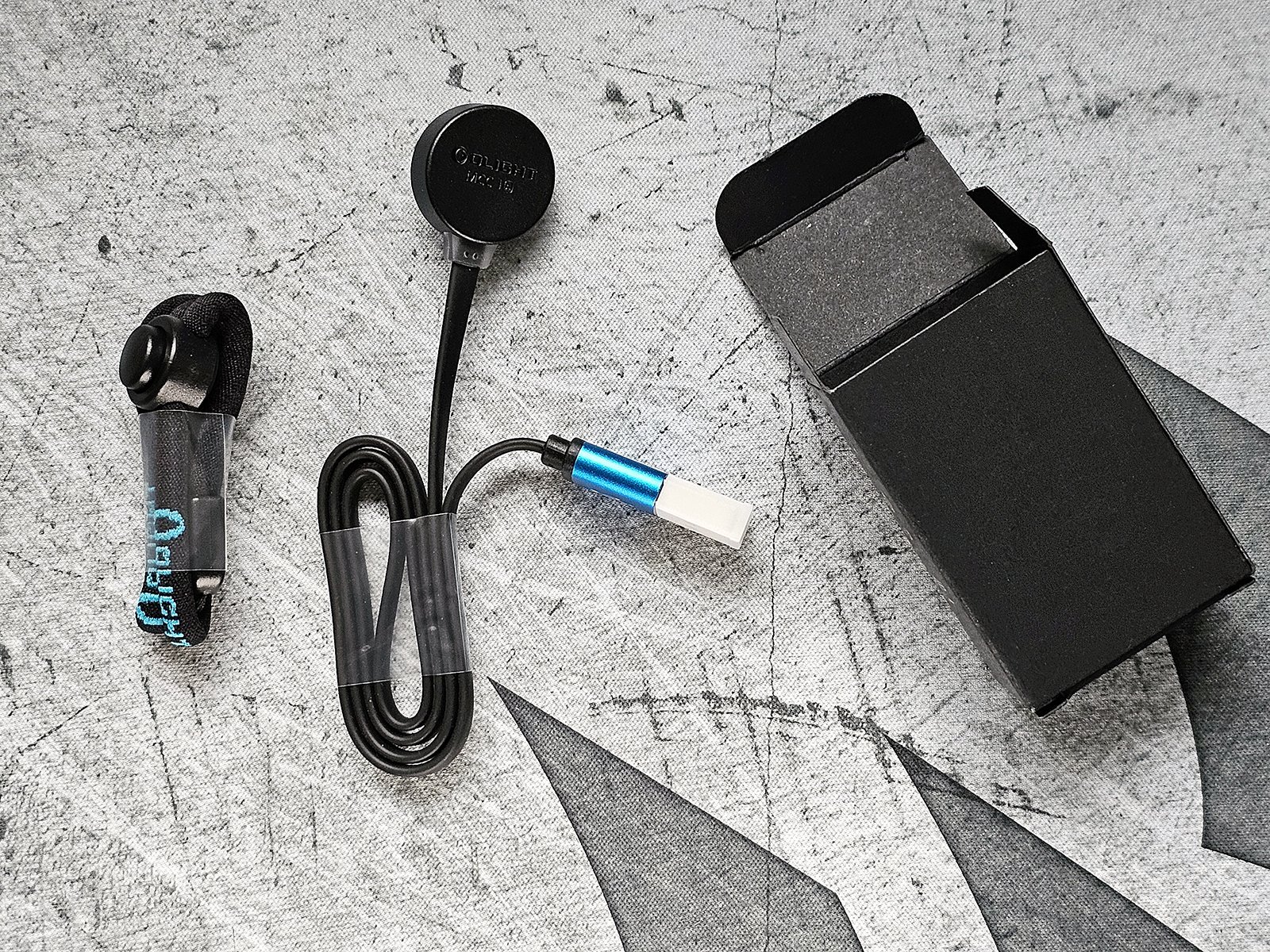

The accessories are a standard Olight lanyard and the charging cable.

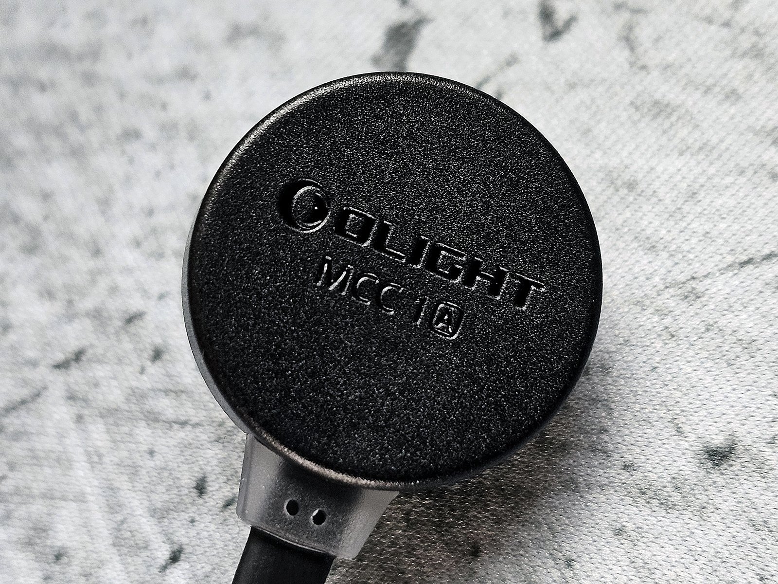

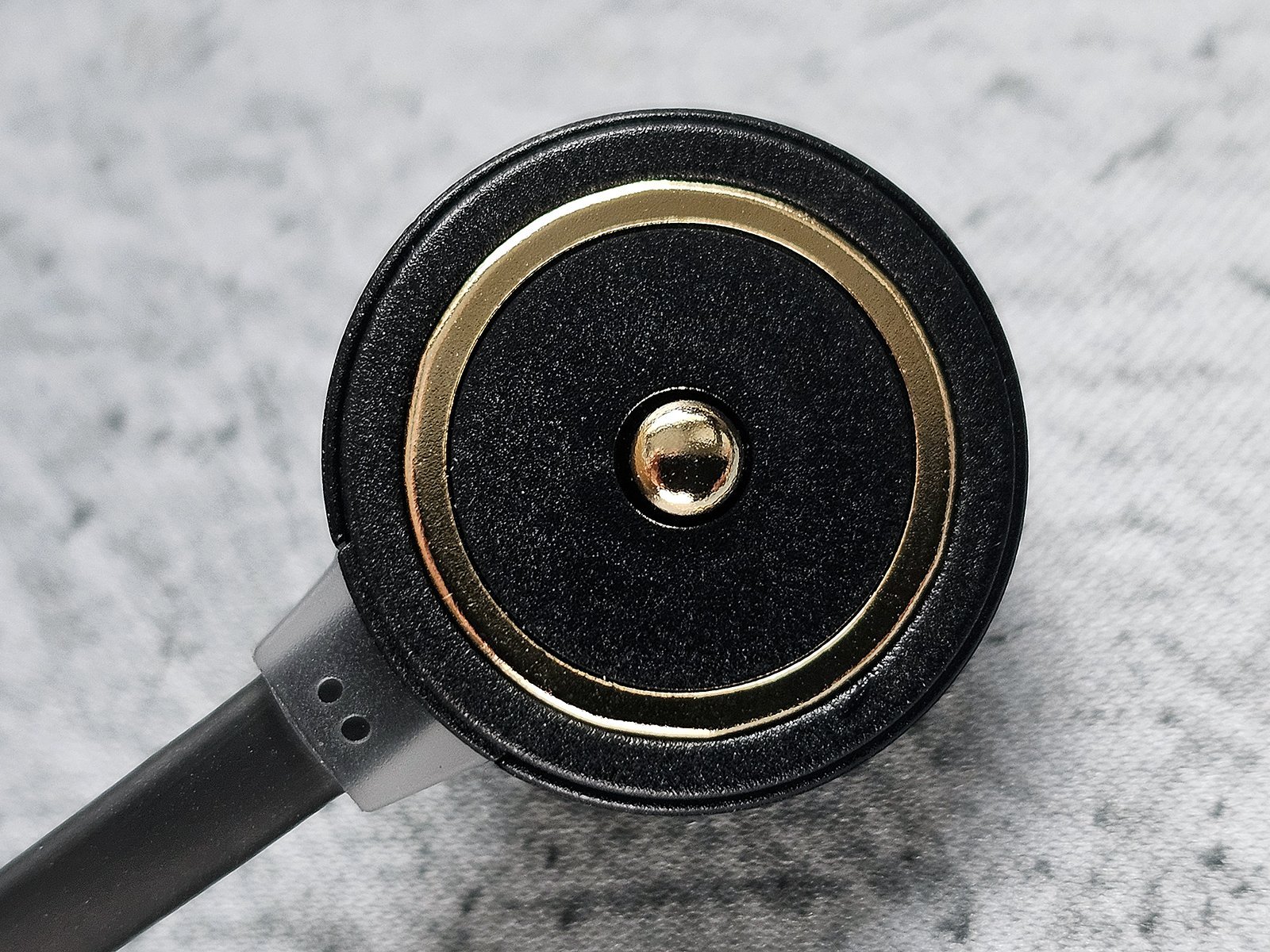

The cable has a magnetic end which attaches to the tail of the torch to charge it, as is the norm with Olight torches. This particular version is rated at 1A.

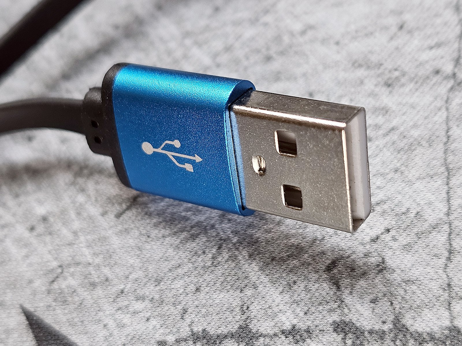

The other side of the charging cable is a standard USB type A plug. I believe it's time to move to USB C for all devices as USB A is bulky and not reversible while most phone chargers now come with USB C.

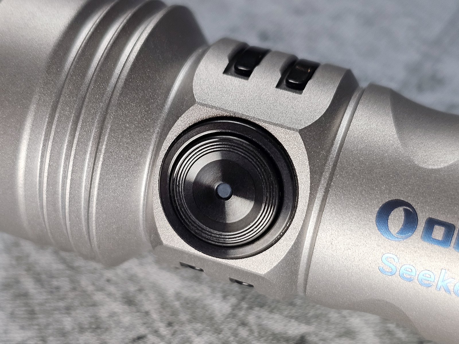

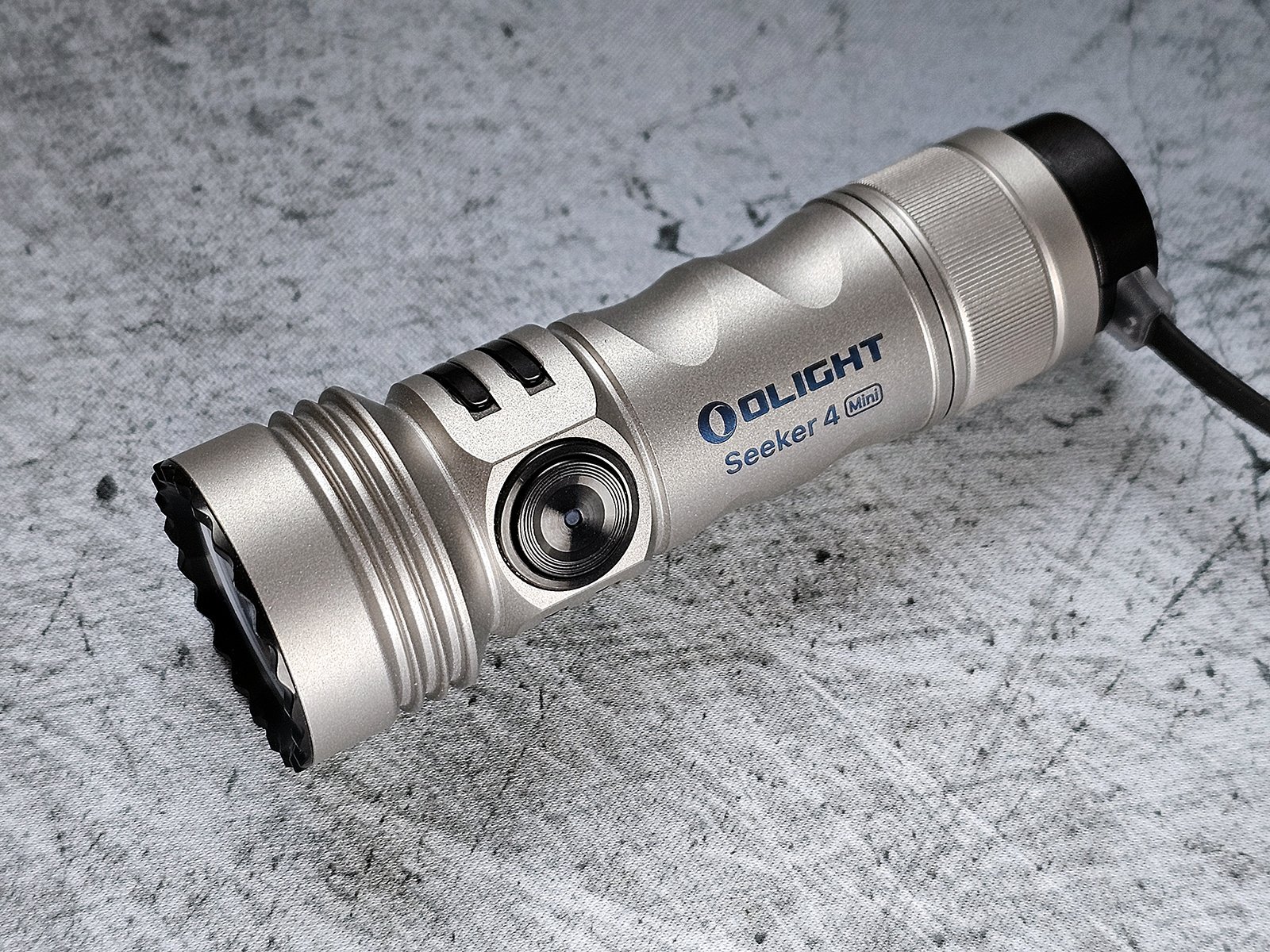

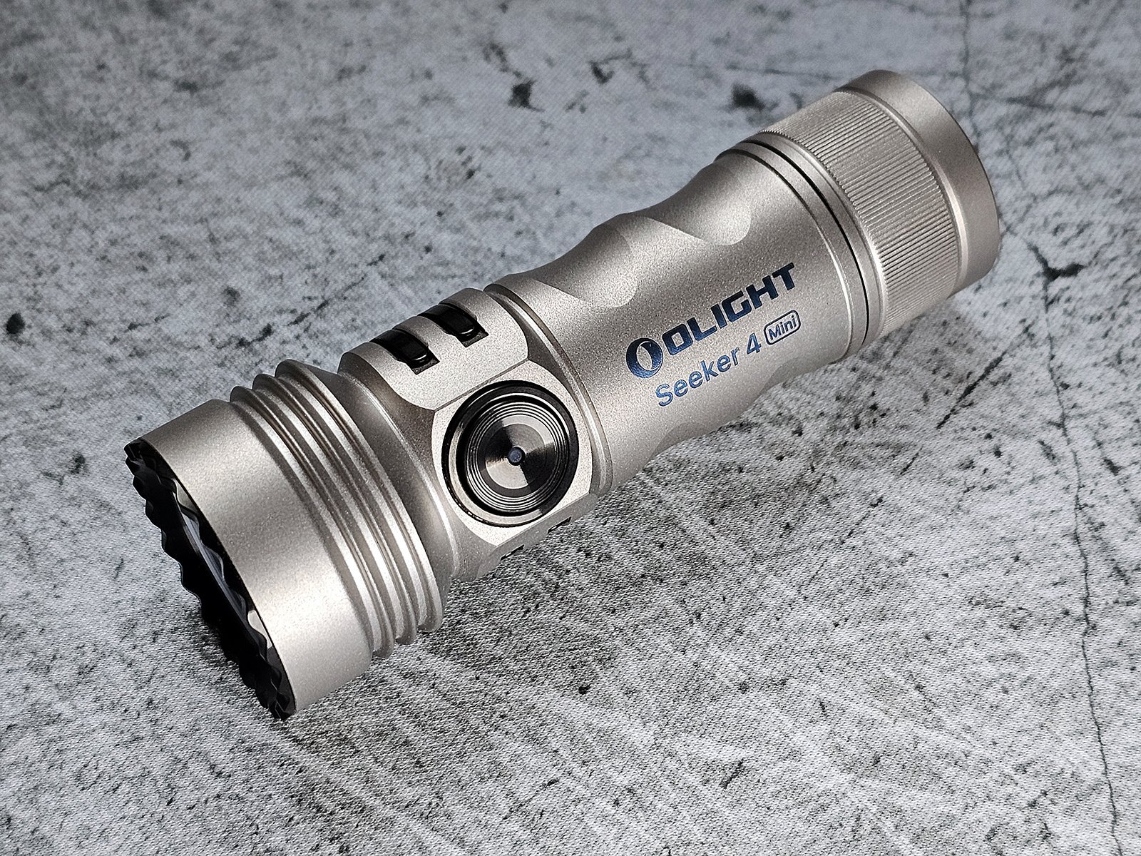

The Olight Seeker 4 Mini Ti is a nice EDC torch with a rather large head and a side button.
The button is made of metal and features an indicator LED in the middle. on the other side of the button there is a preinstalled, bidirectional clip, which is not deep carry. It is functional but not the best looking clip.
The black crenelated bezel is not aggressive and will allow light to spill if the torch is placed head down on a table, which is helpful. The CCT is indicated to be between 5700K and 6700K.

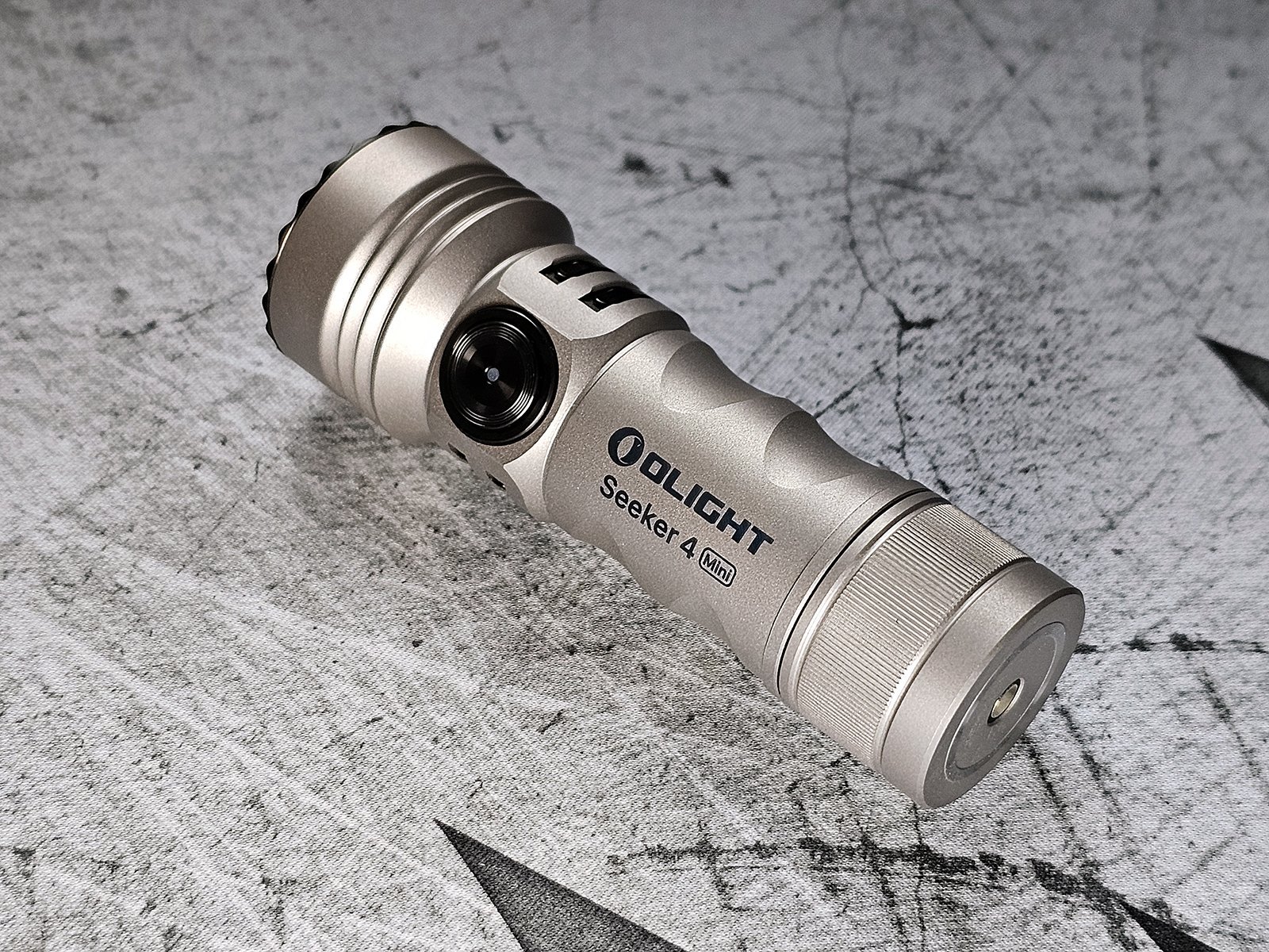

The tail cap is simple and has some texturing to facilitate removal and installation.
UV light is blocked by TIR optics, which forced Olight to use a reflector and lens on this torch. This is a much more reliable and robust configuration, as TIR optics are plastic and can scratch or even melt if used while contaminated. The reflector needs to be physically larger than a TIR optic to focus light effectively, which led to a larger diameter head, frankly on the higher edge of pocketable, but it is a price I am willing to pay to have a reflector instead of a TIR.

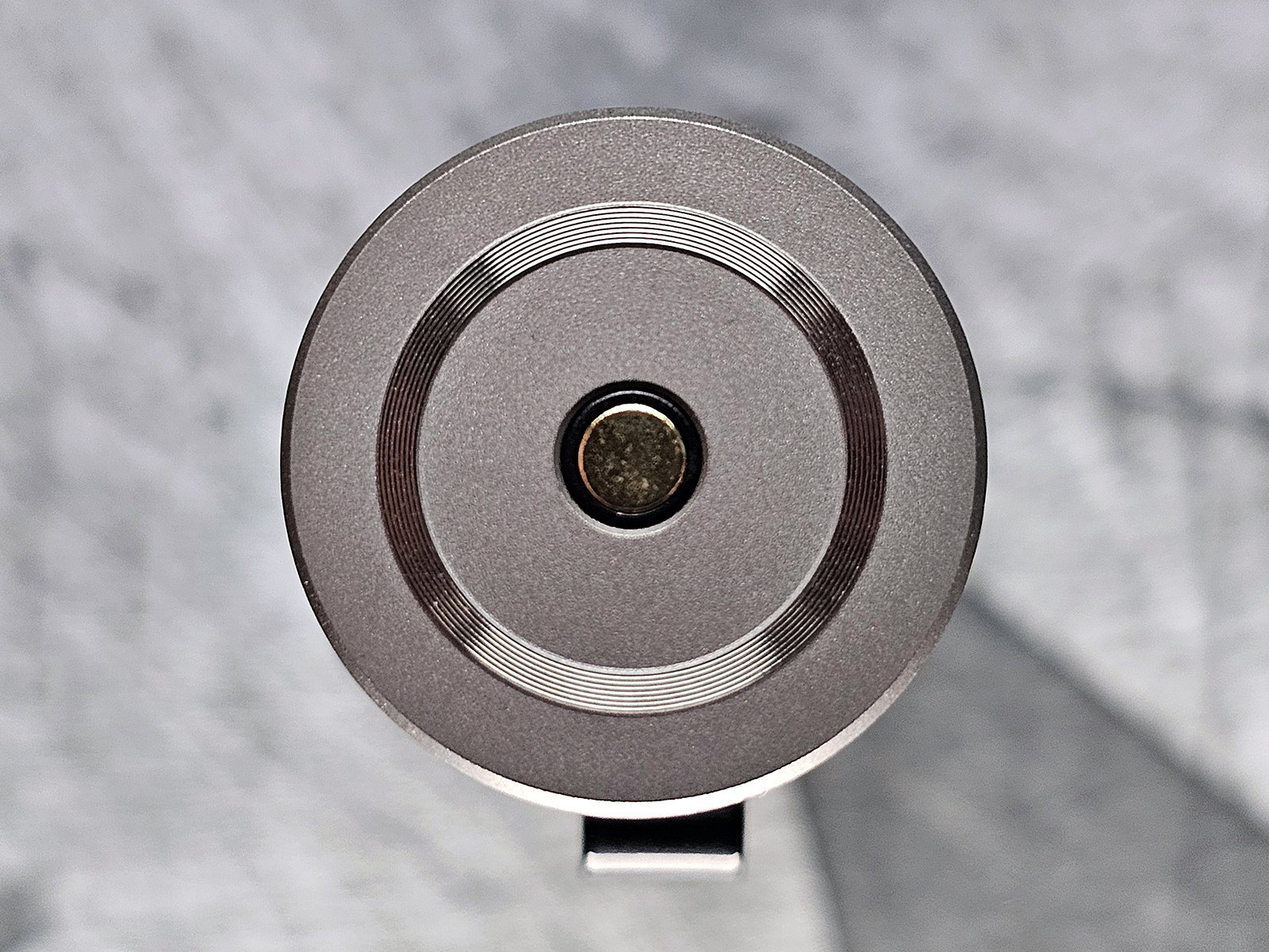

The tail end is the standard Olight design that allows the magnetic attaching of the charger.

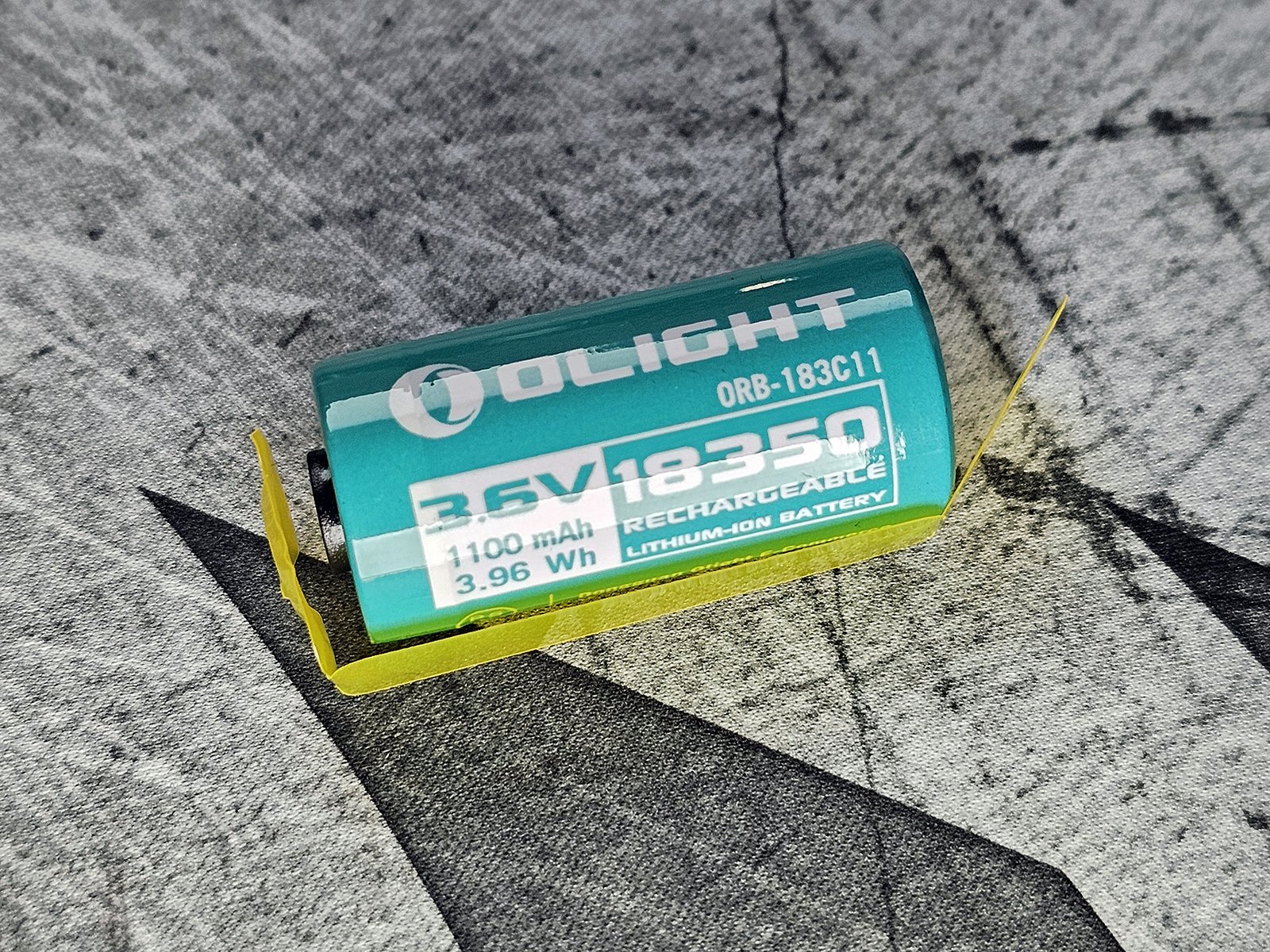

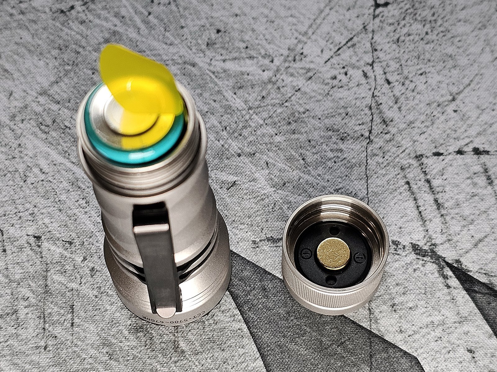

Unscrewing the tail cap reveals the battery, with both of its ends covered by the insulating film.

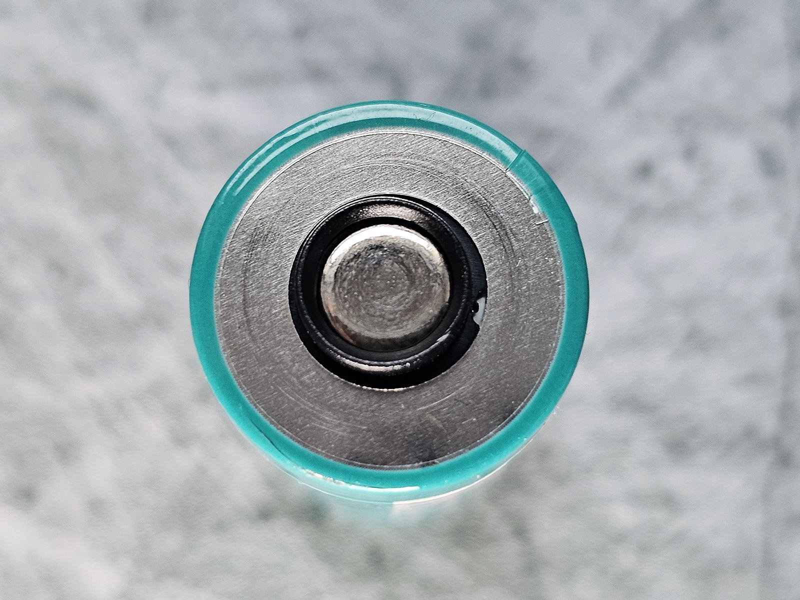

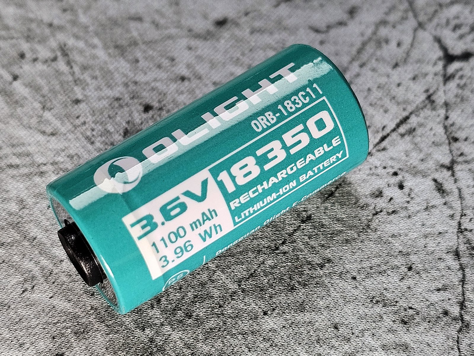

The battery is an Olight branded 18350 Li-Ion with a rated capacity of 1100mAh or 3.96Wh and it is proprietary.
The negative pole is standard, but the positive pole is surrounded by a black plastic insulator and another negative pole around that. This offers both the positive and negative poles on the same side of the battery.

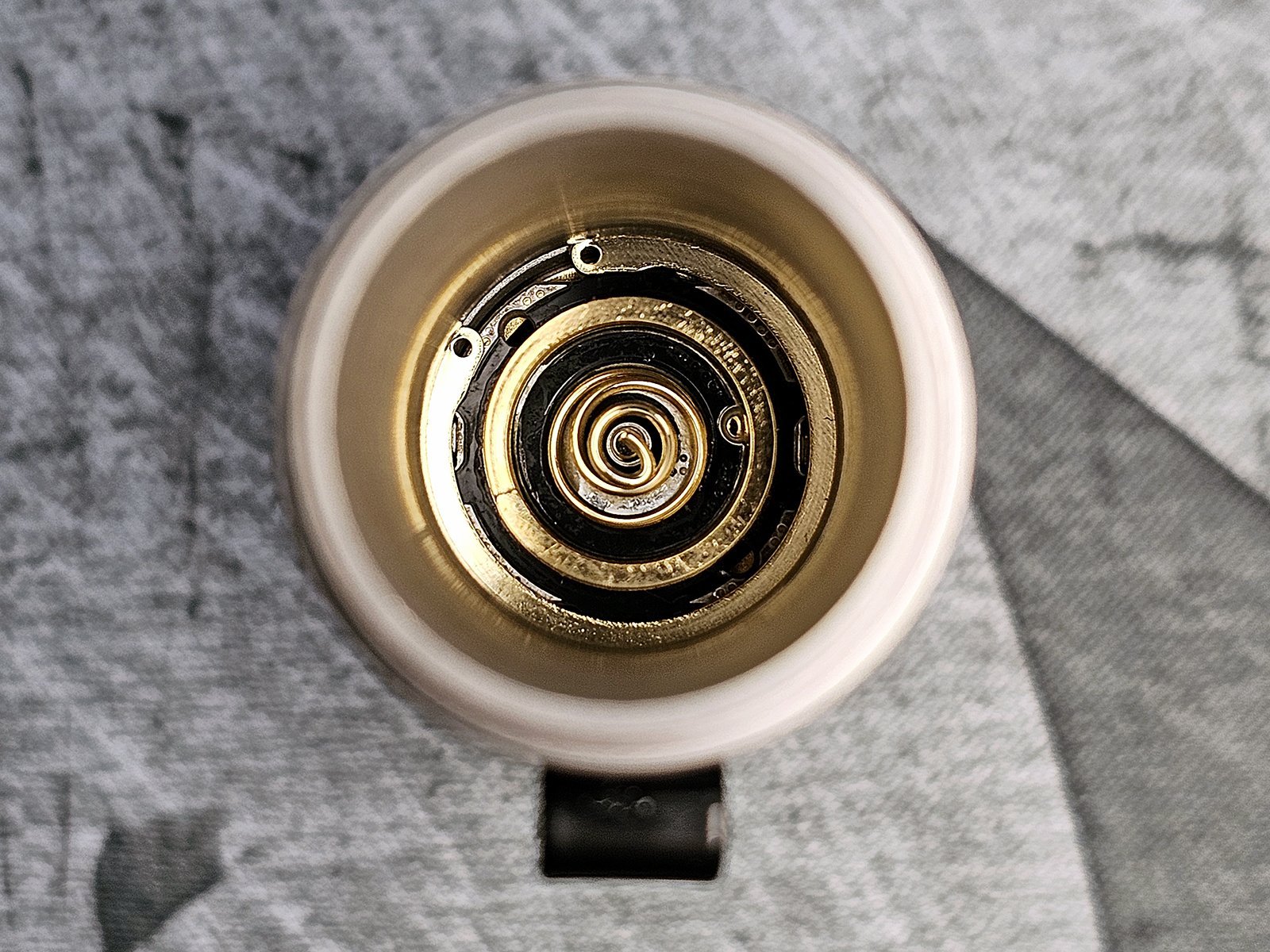

Inside the battery tube, we can see where both positive and negative poles make a connection on the back of the driver, the positive with a spring and the negative with a circle surrounding the spring.
There is also a holding ring keeping the driver in place, which seems to imply that the driver may be removable, although I did not test that.

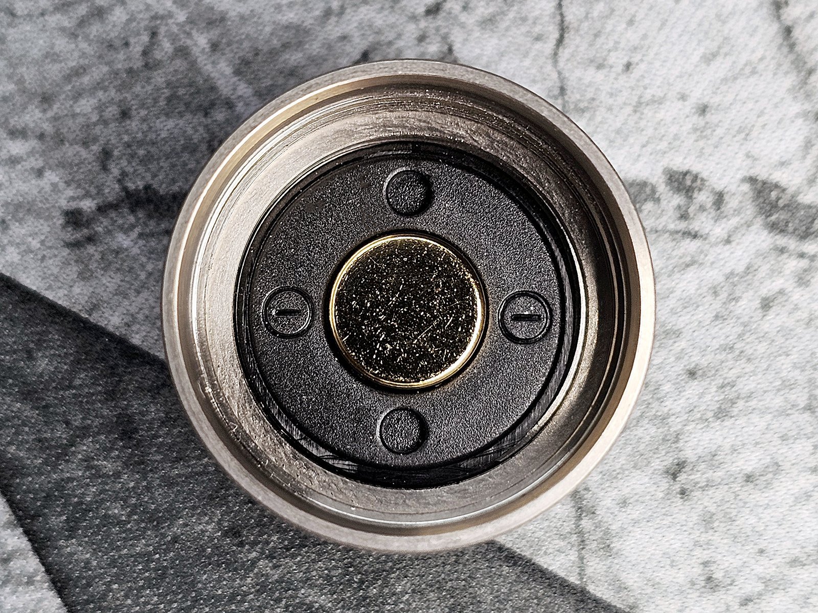

The inside of the tail cap has a spring loaded contact for the negative pole in the middle and an insulator around it. There is an internal tube that carries the positive contact of the charging cable to the driver side.
This complex design facilitates the magnetic charging but also removes the option for the torch to work with any other except the proprietary batteries, locking the user into an ecosystem. Granted, the battery does come included with the torch, but any replacements or extras will have to be purchased from Olight, at a premium price.

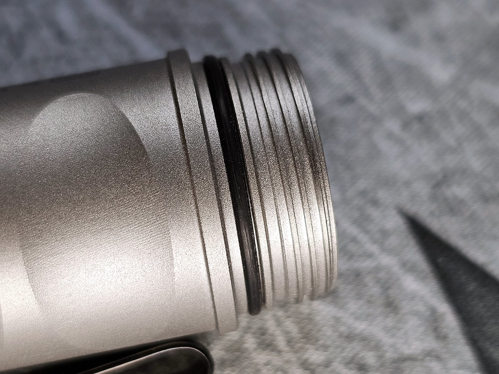

The threads are square cut and well made although quite scratchy, as is the norm with production level Titanium torches. There was no lubrication on the O-ring or threads.

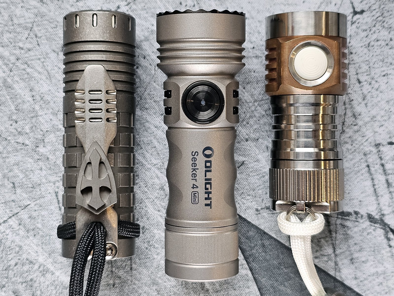

Size wise, the Olight Seeker 4 Mini Ti is larger than most 13650 torches, mainly due to the reflector instead of a TIR. Here it is between the Reylight Dawn and the Hank Wang Emisar D4V2 Ti.

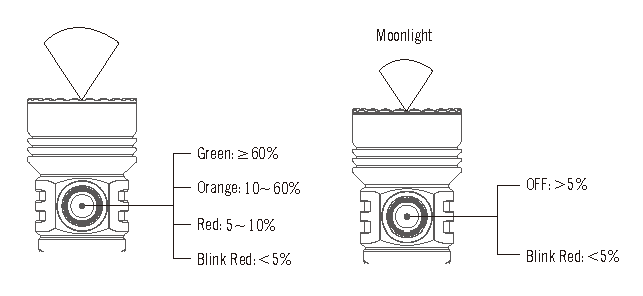

The button of the Olight Seeker 4 Mini Ti features and indicator LED in the middle, which shows the battery level.

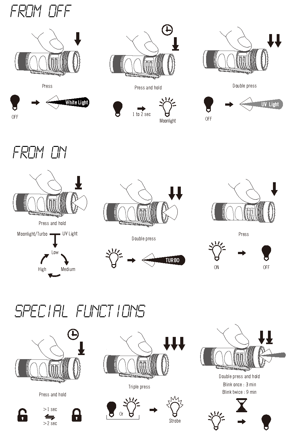

The operation of the Olight Seeker 4 Mini Ti follows the standard Olight operation, with some modifications for the control of the UV light.

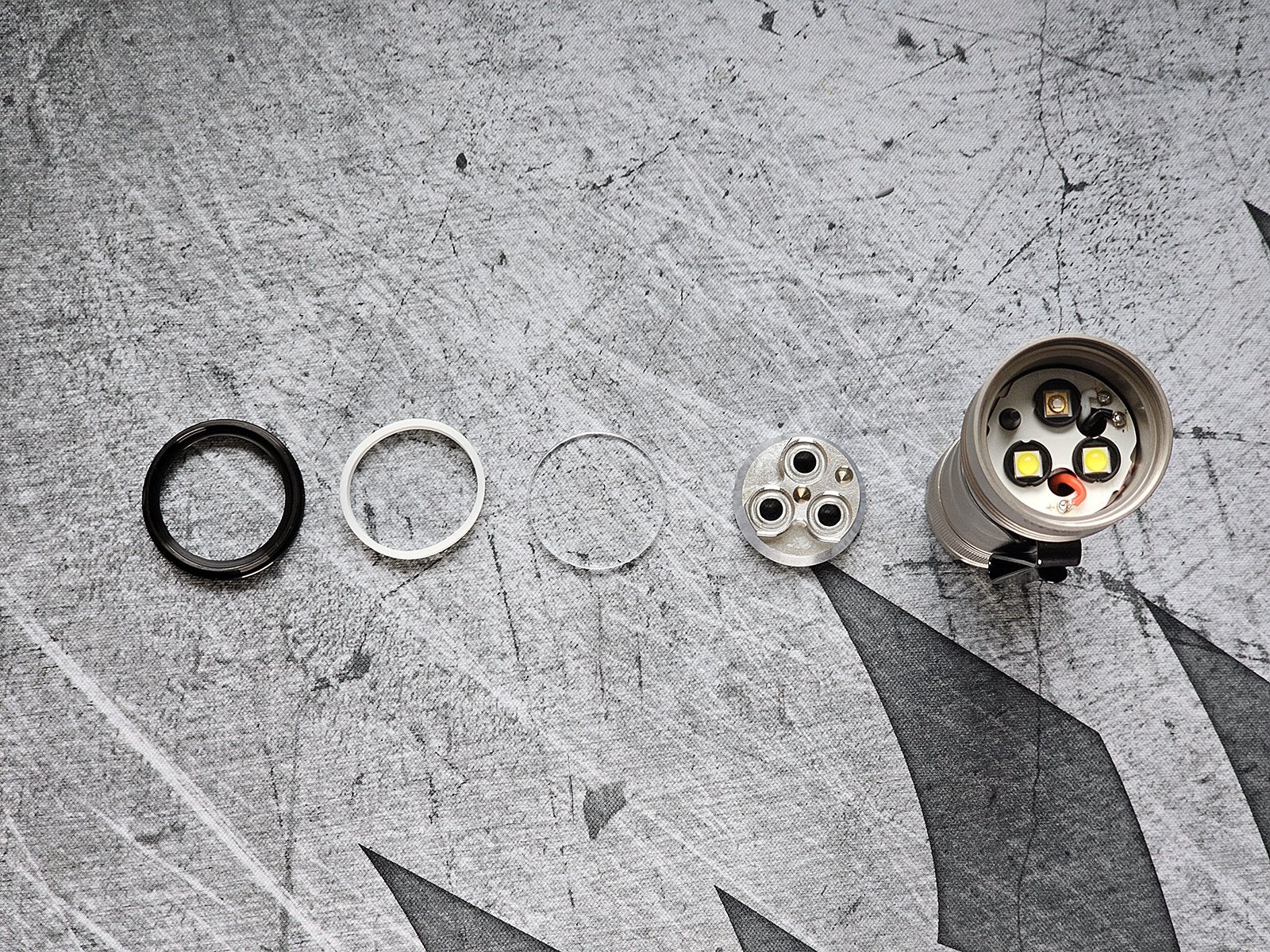

I would not have purchased the Olight Seeker 4 Mini Ti if it was not modable, as I prefer my torches to have nice quality rather than high output light.

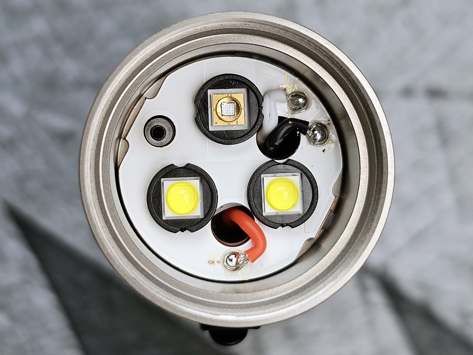

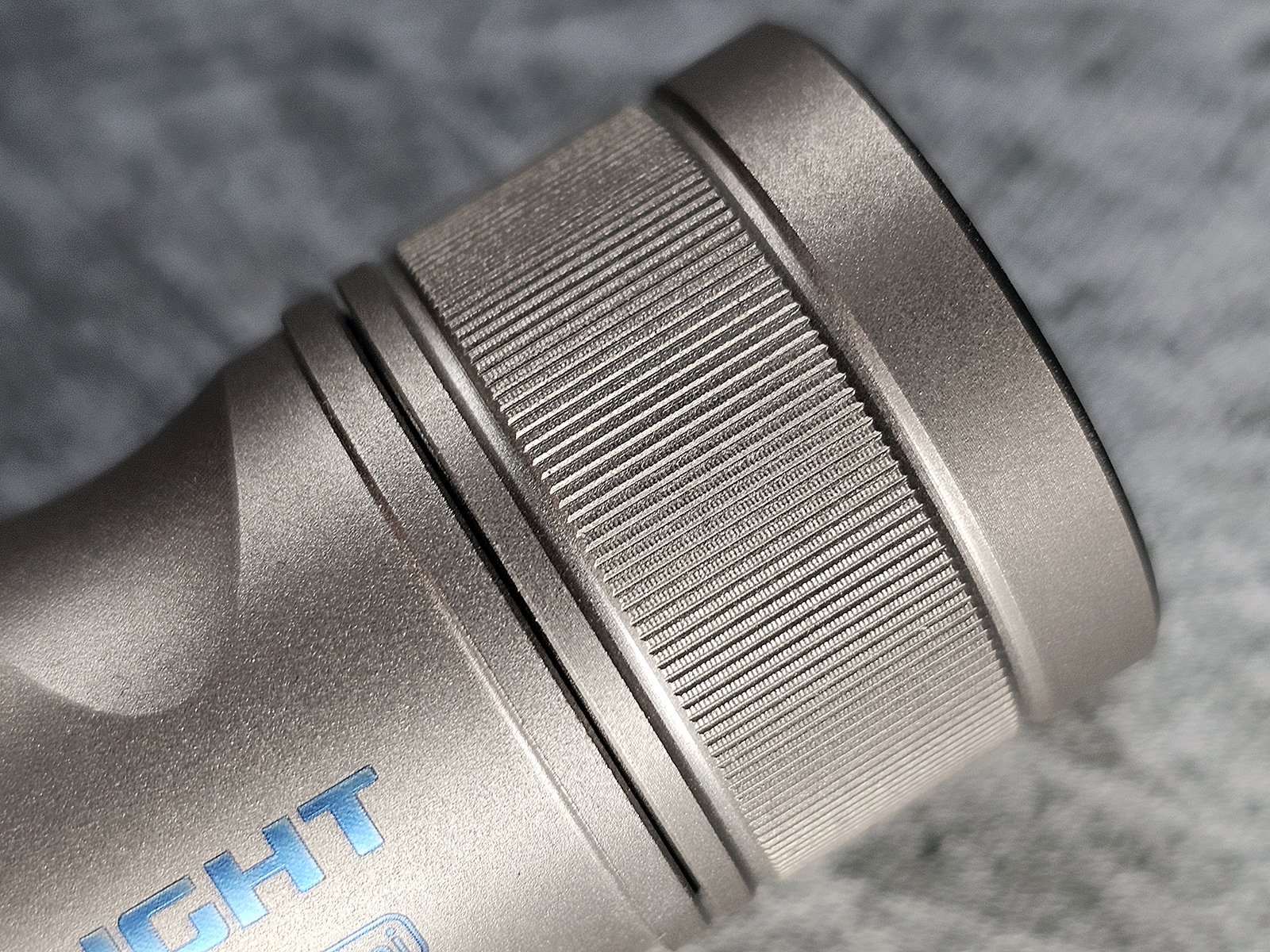

Unscrewing the bezel of the Olight Seeker 4 Mini Ti is pretty straight forward and no tools are needed. Under the bezel, there is a white O-Ring which hugs the edge of the lens and under the lens there is a triple reflector.
Under the reflector, we find the MCPCB.
With a little modding magic, we go from the stock configuration in the first photo, to the eye candy in the second photo. I opted to replace the original emitters, which seem like Osram P9 to me (even though Olight does not state the exact emitter in the specifications), to a mix of Nichia 519a emitters.
Specifically, I used 1 Nichia 519a sm573 (5700K) and 1 Nichia 519a sm353 (3500K). The result will have a CCT somewhere between the 2 and a Duv value lower than both. This is the point using 2 emitters with different CCTs: Because the BBL line is curved, the Duv of the mixed emitters is lower than both of the 2 emitters.

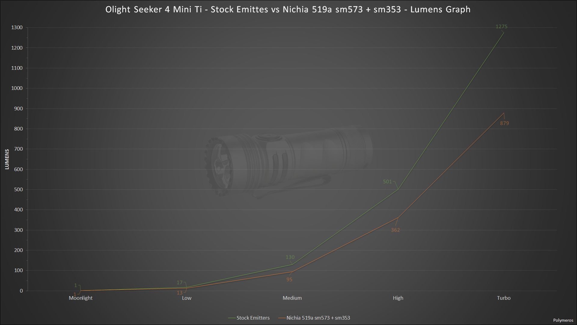

I do not own a multi thousand dollar worth integrating sphere, just a logging Lumen meter and a home made integrating tube. The array is calibrated with 3 professionally measured lights and gives me consistent results, but there is definitely room for error and deviations are to be expected.
My measurements, before (green) and after (orange) the modification are shown in the following table, compared to the stock specs (black).
The following graph shows the lumen output on all modes, before and after the mod.

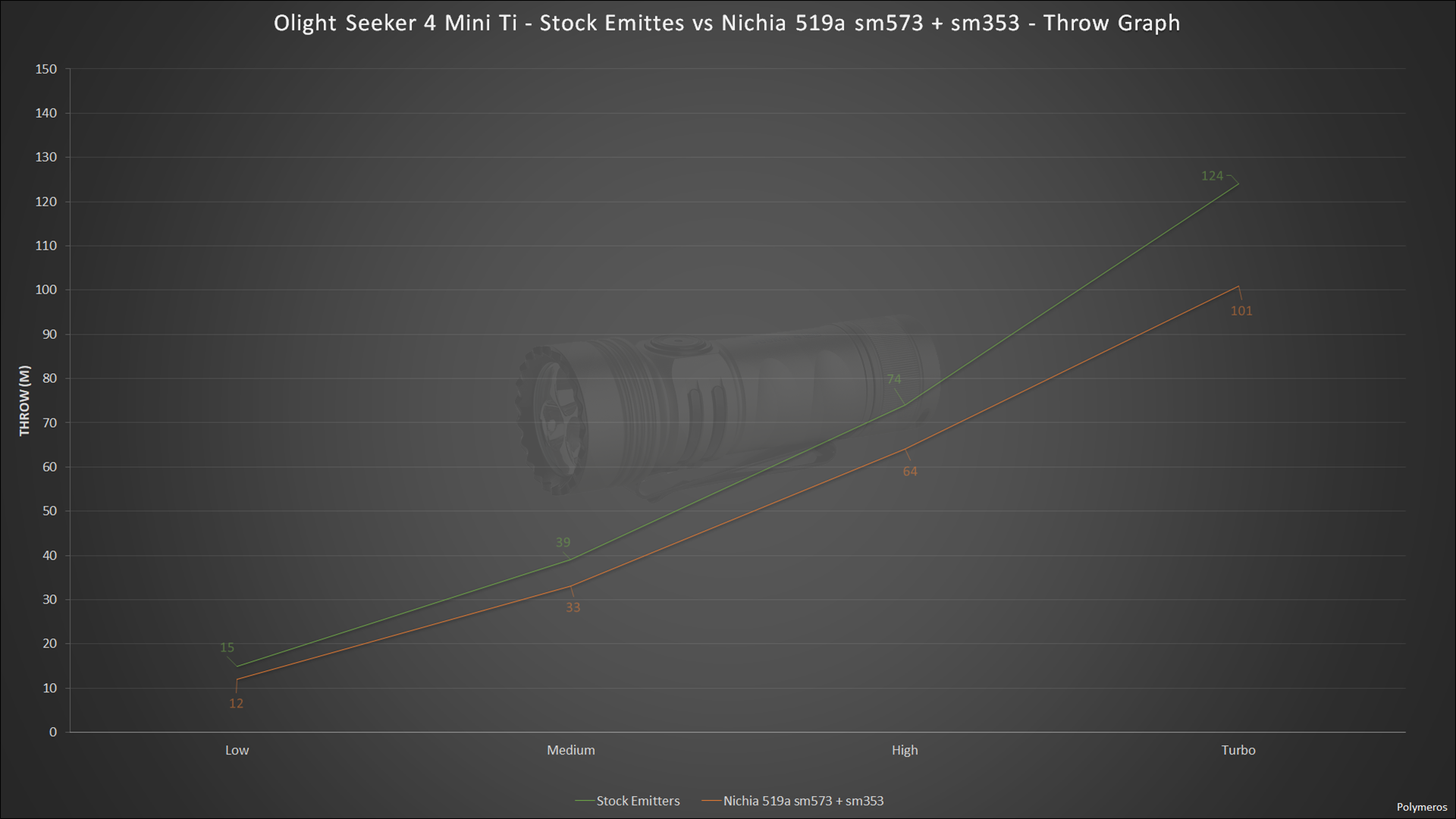

The next graph shows the throw on all modes, before and after the mod.
It is as clear as it was expected that exchanging the Osram P9 emitters to Nichia 519a led to a loss in output. Then why do it? I'm glad you asked. That will become clear in the Photometry section.

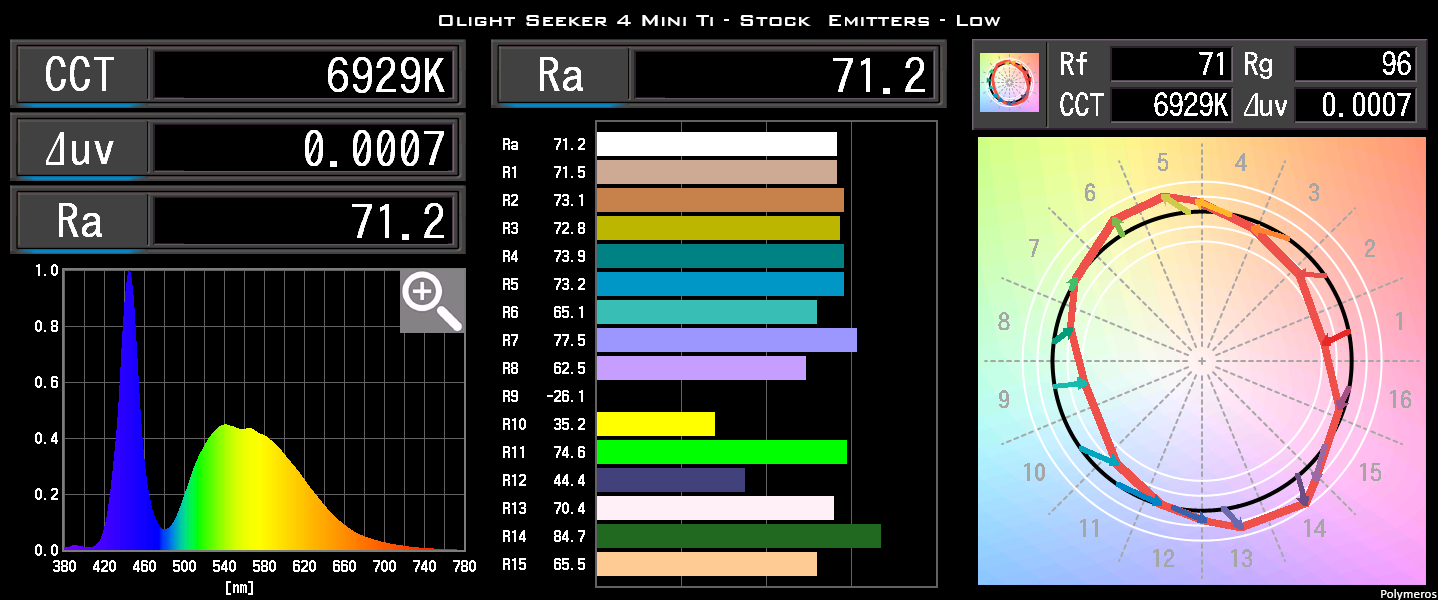

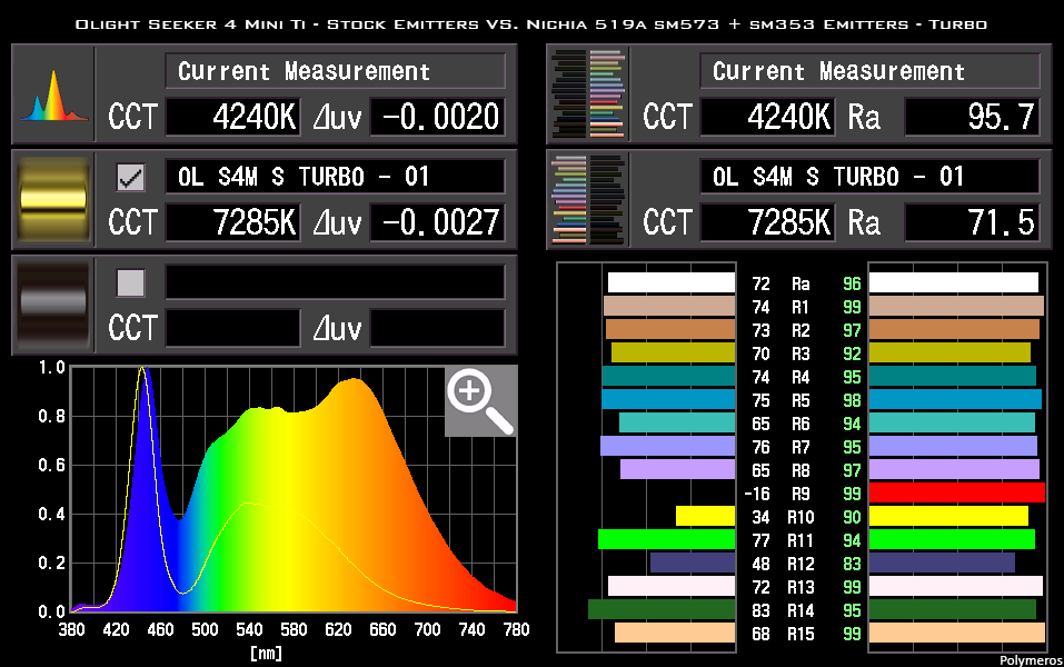

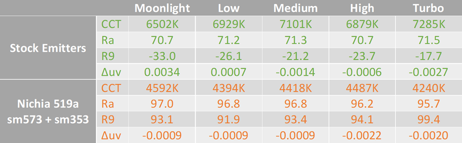

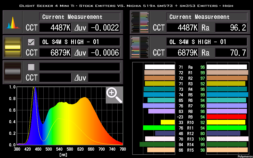

I'm happy to report that to the lasting dismay of my wallet, I now own a Sekonic C-800 spectrometer, so the measurements below should be quite accurate.

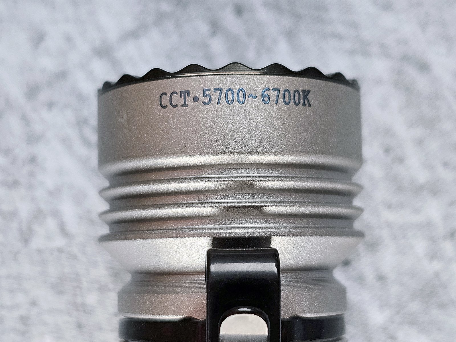

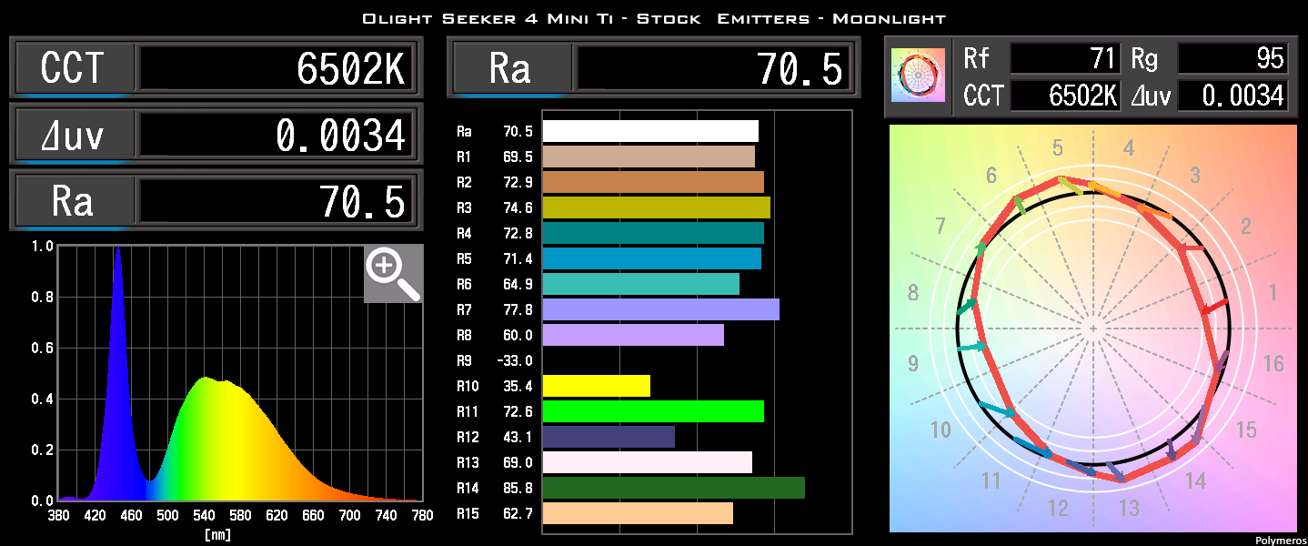

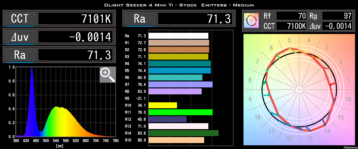

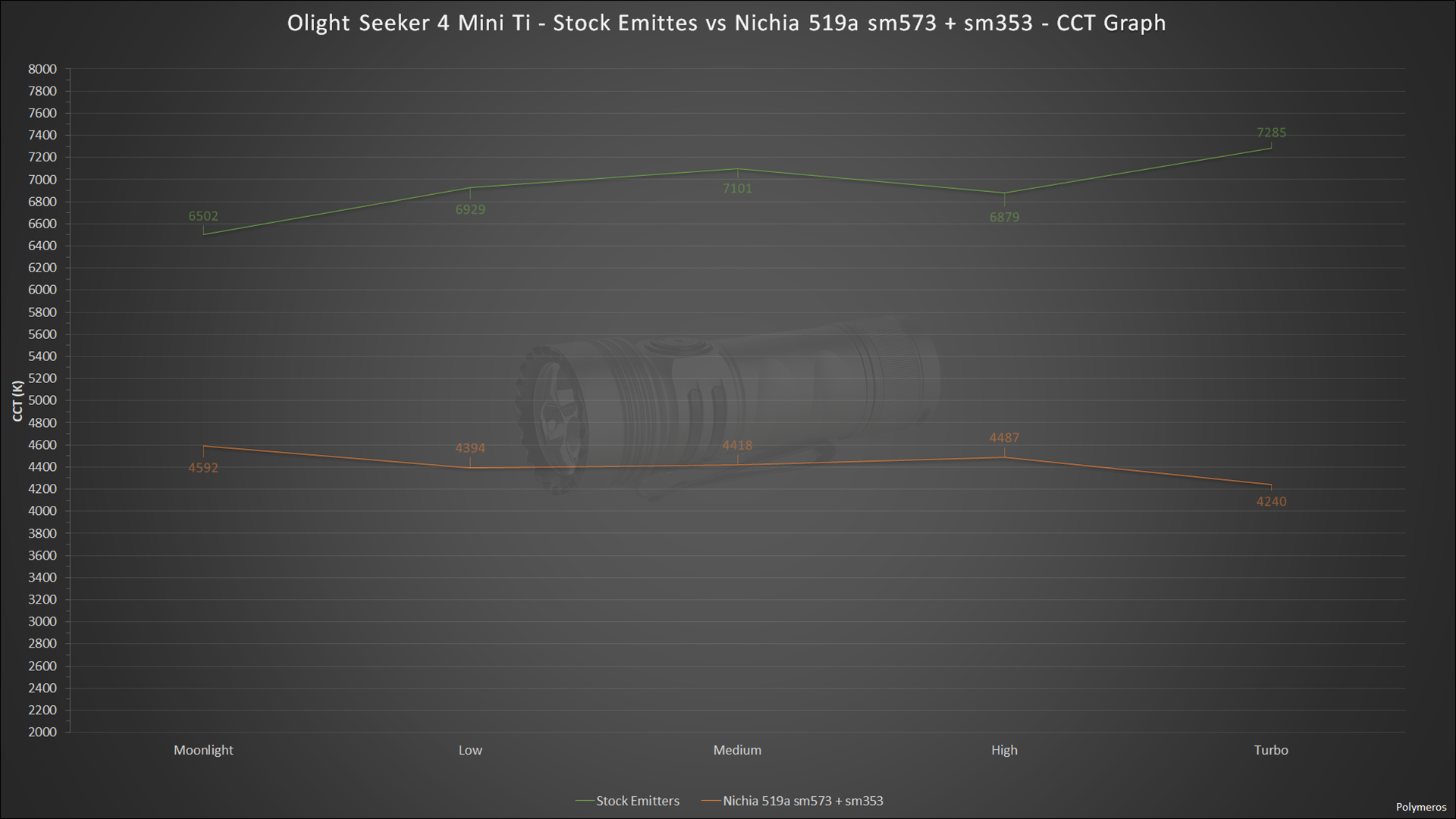

The CCT of the original emitters is very cool. And by cool, I don't mean nice, but rather the opposite, as it starts at 6500K on moonlight and climbs to a bluish 7300K on Turbo, significantly exceeding the CCT values stated in the specifications.
By contrast, the modded version has a CCT between 4200K and 4600K which is excellent for all around use, both in day time and at night. Quite a big upgrade in my opinion.
The Duv is another area of improvement. The stock emitters had a greenish tint on Moonlight mode which became neutral on higher modes and even below BBL on Turbo, even though we can't call it rosy as negative Duvs at 7300K are purple-blue. The modded torch on the other hand offers consistently neutral to slightly rosy Duv!
As for CRI, the difference is clearly massive, with especially the R9 jumping from negative values to consistently over 90!
Here are some graphs to illustrate all of the above.

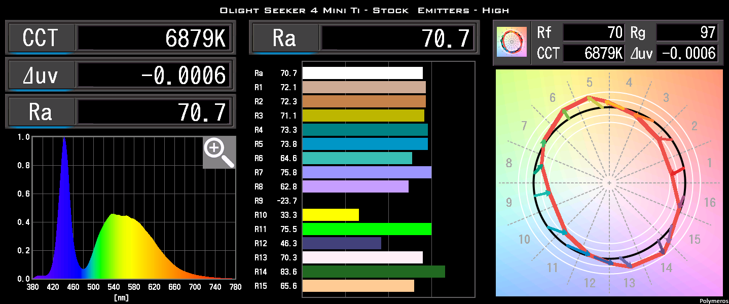

For the more tech savvy readers, I'm including the measurements from the Sekonic C-800.

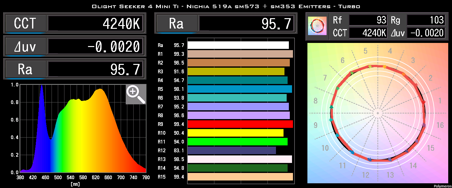

The Spectrogram and CRI clearly show the poor colour rendition of the stock emitters and the TM-30 graph is extremely revealing!
As opposed to the stock emitters, the Nichia 519a sm573 and sm353 mix is pure eye candy! Look at those TM-30 graphs!
Here are the spectrogram and CRI comparisons between stock and modded. The spectrogram overlays are revealing.

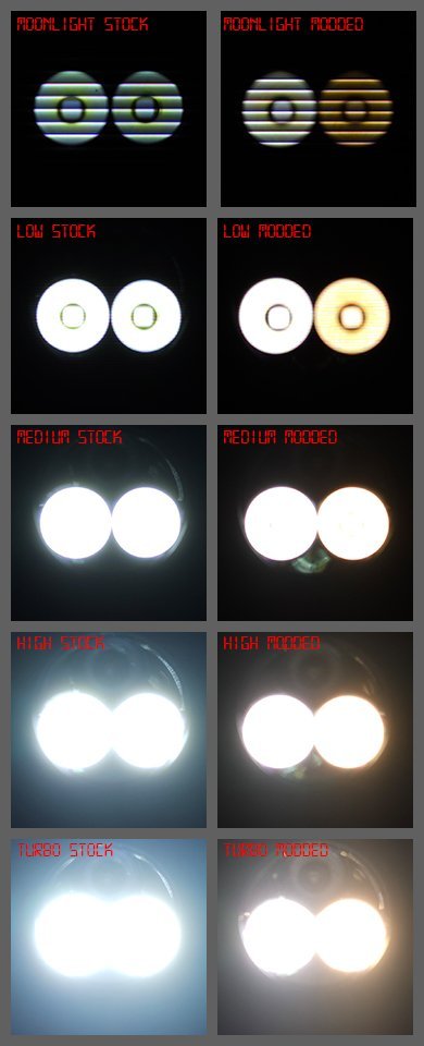

I do not have a driver board to analyse so I have to guesstimate from the torch's behaviour. The driver seems to be a fully regulated buck - boost driver, as it maintained constant output without following the gradual drop of the battery voltage but also depleted the battery to below 3V.

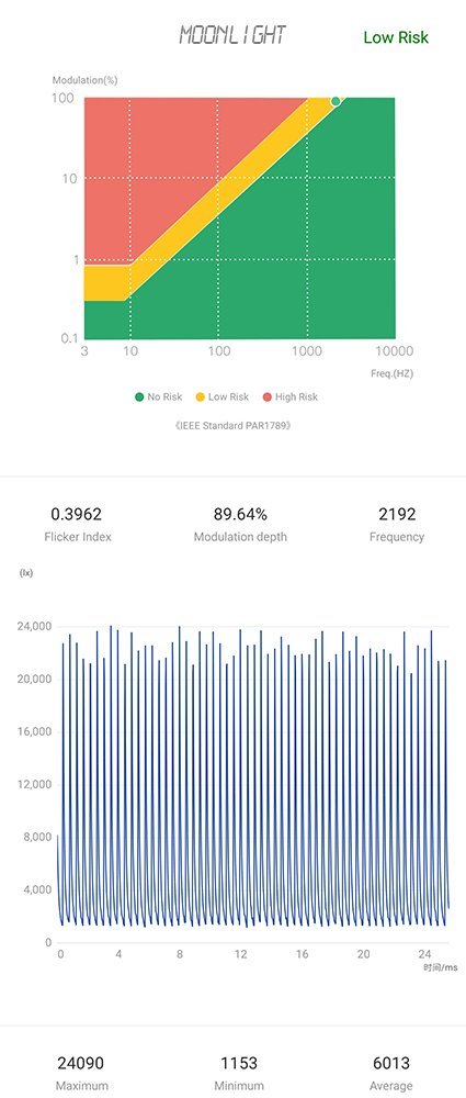

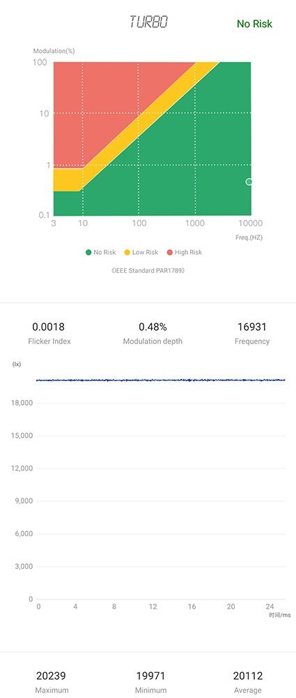

The driver of the Olight Seeker 4 Mini Ti uses PWM to regulate the output and it does so at a very high modulation depth. It also uses a high enough frequency to make it safe on all modes, except Moonlight.
Getting a regulated, constant output driver to deliver a very low output is extremely challenging and most brands opt to either use linear drivers to achieve a very low output or not offer a very low output with their regulated drivers. Olight opted to combine a regulated driver with a 1 Lumen Moonlight mode, which resulted in a PWM frequency of 2.2KHz being used. This is tiring to the eyes and is considered a low risk.
Here is what my camera saw, at a shutter speed of 1/12000 sec.

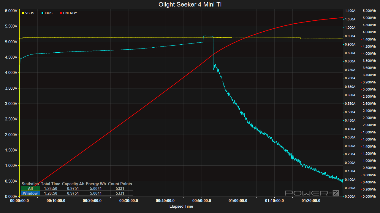

The charging of the Olight Seeker 4 Mini Ti is quite simple. Just get the magnetic charging cable anywhere near the tail end of the torch and it will snap into place and begin charging.
The indicator LED on the charging cable will be red while charging and turn green when the battery is fully charged.
The following chart shows the charging of the battery inside the Olight Seeker 4 Mini Ti, after it had been depleted to the point where the torch turned itself off. At that point, I let the battery rest and then measured it at 2.85V. The charging used a maximum current of 0.951849A and was completed at a total charging time of 1 hour, 28 minutes and 50 seconds. This charging process used a total of 5.0041Wh. The voltage of the battery at the end of charging was 4.19V.
